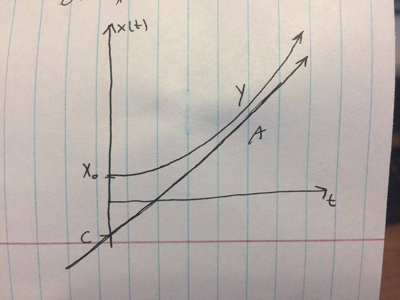

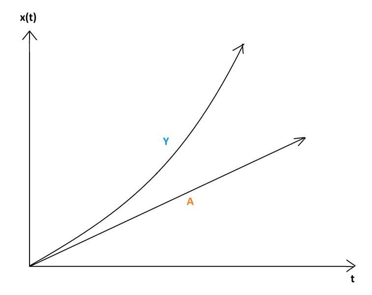

Thank you so much. Here is a quick graph I made - is this correct?

ruskointhehizzy said:
Okay I understand that the approaching car will be a straight line because it has constant speed, but I don't understand why X0 is negative? That totally makes sense to graph it I don't know why I didn't think of that. Could you explain to me how you got x = 1/2at^2? I can see how that will be a curve because you are going to have to floor it and you will gain speed at an exponential rate. I also don't understand what you mean by car A is at x = -x0 at t = 0.
I did not say ##x_0 < 0##; in fact, we need ##x_0 > 0## because when you start from ##x=0## and accelerate to the right (to positive values of ##x##), the approaching car is to your left on the x-axis, at position ##-x_0 < 0##. (Alternatively, you could say the initial position of A is ##x_0##, and require that we have ##x_0 < 0##.)
And no, your graph is not correct. You have the cars together at time 0, just when you start to accelerate. Car A was supposed to be separated from you when you start to accelerate.

I guess I don't understand how you go the equation for the line A where you say it is in the form x = -##x_0## + vt, because the equation in my book says x = ##x_0## + ##v_{0x}##t - I see how ##x_0## will have to be greater then 0 now and I fixed my graph. I think I know what you are saying, it could either be like I have it or A could start at a -x value and Y would start at x = 0. Sorry man this may be trivial but I have only been doing physics for about 2 weeks and it is all still really new to me.

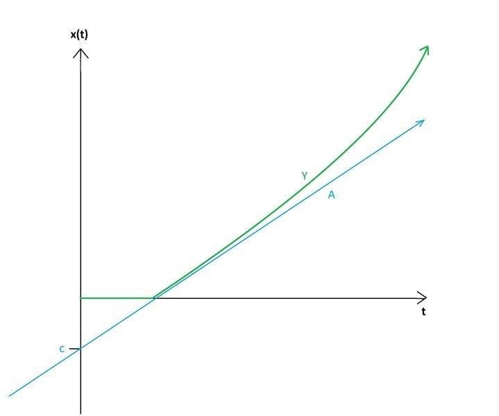

OK, if you don't like ##x = -x_0 + vt## let's just change it to ##x = c + vt##. At ##t=0## the position is ##x=c##, and we had better have ##c < 0# because car A is not supposed to be at the position of car B yet.
Your graph is still not correct: car Y (you) starts off at speed 0, so the t-axis should be tangent to your (x,t)-graph at the starting point; you have the tangent sloping up, so somehow your car was instantly launched at a positive velocity---maybe on a catapult?

I see what you mean lol - yes it was launched by a catapult, let me correct that.
thanks for sticking with me through this

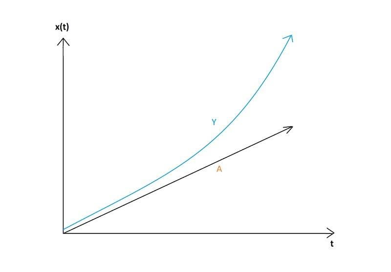

I hope this graph is correct, I have the car Y sitting at the red light at x = 0 - and sees the oncoming car A at const v. Then before they hit he takes off - I think I captured that in this graph.
No. You have the car at the lights waiting until collision is just about to occur, then instantly moving at speed v, which would require infinite acceleration.
Forget the question for the moment and just graph displacement of a car undergoing constant acceleration from rest.

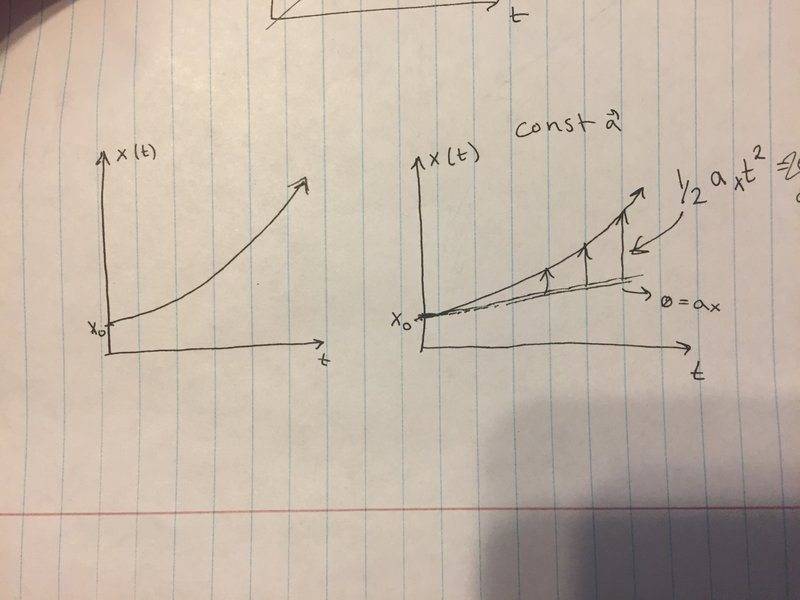

here is the displacement for an object with constant acceleration. on the right is showing a line with zero acceleration and the effect that the acceleration has on it.

I have now just added the A line to that.

You are getting close. You have assumed that YOU are at ##x_0 > 0## when you begin accelerating. Of course, you are free to consider your starting point to be anywhere you want, so maybe you do start from ##x = x_0 = 147.3##. However, that seems too complicated. Life is much simpler if you assume you start from ##x = 0##, with YOUR ##x_0 = 0## but the approaching car's ##x_0 < 0##.
The reason I am belaboring this issue is that I am not convinced you really "get it". You should think about it and proceed carefully. Drawings can be rough sketches, but they should try to capture the main features of a problem.
Again, let me emphasize that you can choose starting points however you want, so you could start from ##x = p## at the moment the approaching car is at ##x = q##. What you really want is to determine the distance ##p-q##.

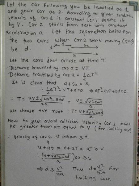

You can get there a bit faster by using the frame of reference of one car and running time backwards. With constant acceleration a, when the distance reaches d the speed difference is v.

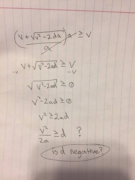

thanks man - I went through it and I got this:
I thought about it - and I noticed you d is facing the opposite way of s1 and s2, is d negative and thus why you switched the inequality sign? Thanks again that problem kicked my ass but seeing it solved really helps. In math I am used to getting values and solving problems but in something like this where they don't give me any values really just gave me writers block, if that is a thing in math/physics :P. Take care.

PrathameshR said:
When I replied earlier I failed to notice that you were not the original poster of the thread.
Forum rules: do not post complete solutions for others' homework problems. The idea is to point out mistakes, clear up misunderstandings and give hints, that is all.

I was getting close to end of my board so skipped some steps hence flipped inequality by mistake. d distance and not position or displacement so there's no need to label it as positive or negative. Sorry for not providing the hints and directly stating the answer.

I was going to mention that but it was due yesterday so seeing the answer I feel is okay since I won't get credit for it anyways.
that's fine man I was able to work through it - I appreciate the solution, it helped me learn in this situation but I learn best when asked questions so I can provide my own solution. I know your intentions are best at heart though, and this was due yesterday so it is totally fine. Thank you again man. No worries on the rules I am new here as well man. Take care!

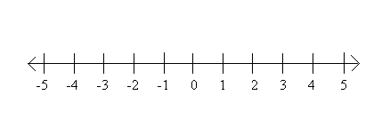

Of course. Surely you must have seen a "number line" before? East = positive ##x##, west = negative ##x##.
