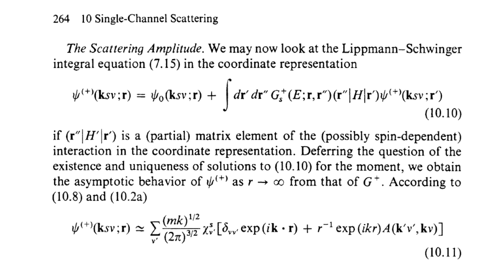

As for the book I am reading, here is a small excerpt. I refrained from directly citing it before since it does not use Dirac notation explicitly. But perhaps the following passage will help,
Book: Roger G. Newton: Scattering Theory of Waves and Particles (Great book by the way, has been of tremendous help to me).
You can see in equation 10.10 a very similar expansion as I wrote down in my previous comment. The ##\psi_0(\mathbf{k}s\nu ; \mathbf{r})## is in my notation the projection ##\langle \mathbf{r}|\mathbf{k},s, \nu\rangle## with ##s, \nu## spin quantum numbers. Here (and in several other derivations) it seems to me as if the author injects just a complete set of position states, without also injecting spin states with it. In 10.11 then you can see that the resulting wave function is still a spin vector, since the symbol ##\chi_{\nu}^{s}## is simply the ket ##\ket{\nu,s}## in my notation.

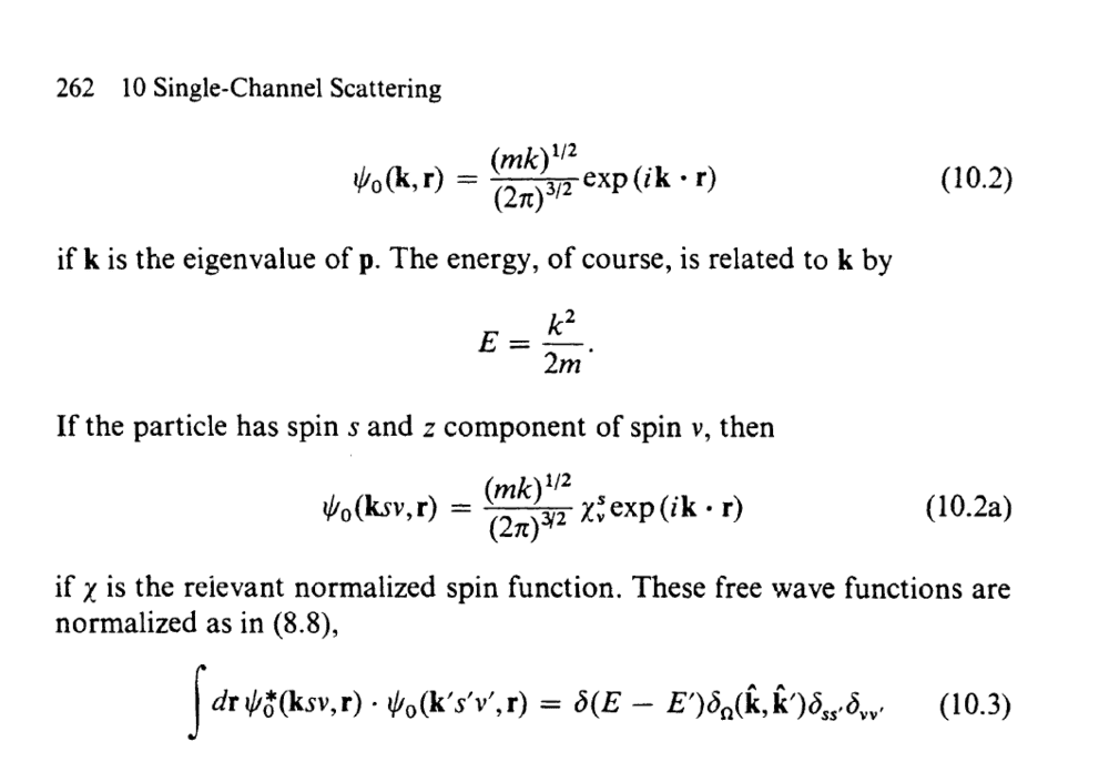

Ok, the ##\psi_0## is the plane wave of the incoming particle. Newton writes it with all the parameters. It's a momentum eigenstate with momentum ##\vec{k}##. Since it's a free particle that's at the same time an energy eigenstate of energy ##E=\vec{k}^2/(2m)##. Further it's a particle with a specific spin-##z## component ##\nu## of particle with spin ##s##. ##\chi_{\nu}^s## is the simultaneous eigenvector of the ##\hat{\vec{s}}^2## to the eigenvalue ##s(s+1)## and ##\hat{s}_z## to the eigenvalue ##\nu## (##\nu \in \{-s,-s+1,\ldots,s-1,s \}##).
Further he normalizes the state in a specific way, convenienf for the scattering problem. It's clear that you have
$$\int_{\mathbb{R}^3} \mathrm{d}^3 r \psi_0^*(\vec{k}s\nu,\vec{r}) \psi_0(\vec{k}'s' \nu',\vec{r})=C \delta^{(3)}(\vec{k}-\vec{k}') \delta_{ss'} \delta_{\nu \nu}'.$$
Now consider ##\vec{k}## and ##\vec{k}'## written in spherical coordinates ##(k,\vartheta,\varphi)## and ##(k',\vartheta',\varphi')##. It's easy to show that the ##\delta## distribution transforms into
$$\delta^{(3)}(\vec{k}-\vec{k}')=\frac{1}{k^2 \sin \vartheta} \delta(k-k') \delta(\vartheta-\vartheta') \delta(\varphi-\varphi')=\frac{1}{k^2} \delta(k-k') \delta^{(2)}_{\Omega}(\hat{k},\hat{k}').$$
Now you can express ##k## and ##k'## by the corresponding energies
$$E=k^2/(2m) \; \Rightarrow \; k^2=2m E.$$
Since ##k>0## you can uniquely write
$$\delta(k-k')=2k \delta(k^2-k^{\prime 2})=2k \delta[2m(E-E')]=\frac{k}{m}\delta(E-E').$$
So you can choose ##C## such that the normalization condition (10.3) is fulfilled.

$$A(\vec{r},s,\nu;\vec{r}',s',\nu') = \langle \vec{r},s,\nu|\hat{A}|\vec{r}',s',\nu' \rangle.$$
Maybe Newton has operators in mind which trivially act on the spin, i.e., ##\hat{A}=\hat{A}(\vec{x},\vec{p}) \otimes \mathbb{I}_{\text{spin}}##, because then
$$A(\vec{r},s,\nu;\vec{r}',s',n')=\tilde{A}(\vec{r},\vec{r}') \delta_{ss'} \delta_{\nu \nu'}?$$
