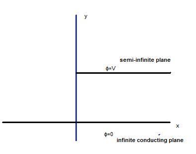

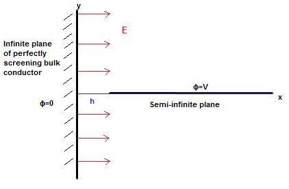

Consider a semi-infinite sheet of (infinitely thin) conductor charged to a potential [tex]V[/tex]. It is placed at a distance [tex]h[/tex] perpendicular to a perfectly screening bulk conductor (so the electric field is always perpendicular to the surface). See the attachment below. I want to investigate the charge density on the surface of both sheets. I'm struggling to determine the transformation that can describe the electrostatic field.
Now, I have calculated a similar problem with a semi-infinite conducting plane paralell to an infinite conducting plane at a distance [tex]h[/tex]
I have transformed it into the upper half-plane (so it looks like a capacitor), and I found the transformation

determines this electrostatic field. How can I transform my problem with perpendicular planes into something similar? Can I use this result, with another transformation? Any help would be greatly appreciated.
You should have posted this in the Physics boards, because not all the Math students are familiar with electrostatic concepts (sigh).
