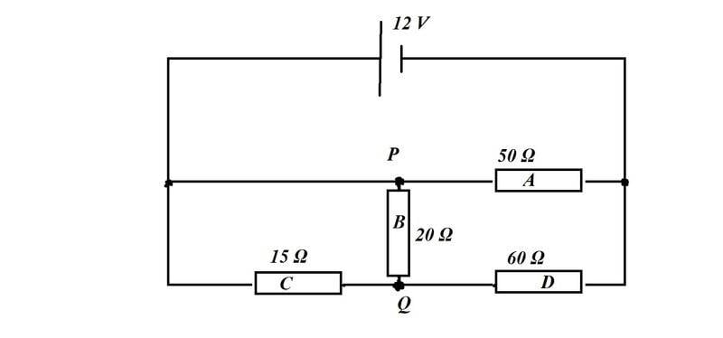

In the circuit shown below, I will determine the voltage between points P and Q. The answer is given but my problem is that I can not find the total resistance in the circuit.
V=R*I
The true answer is : The voltage between P and Q is 1.5 V.

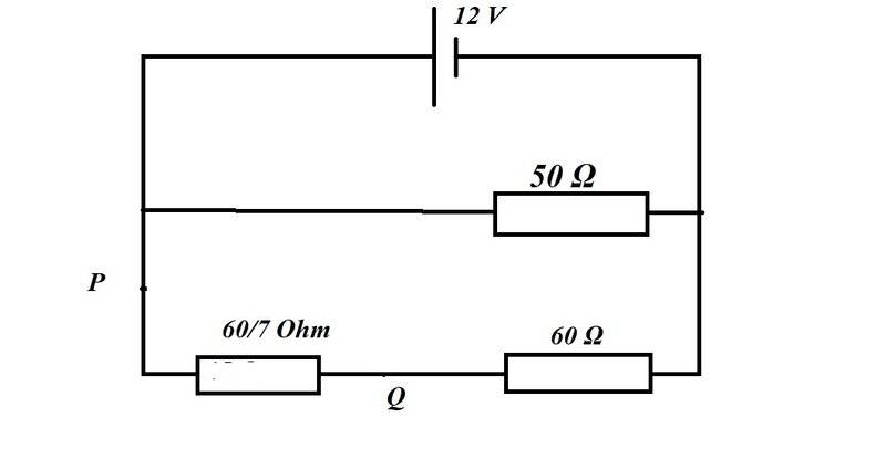

I got stuck finding the total resistance. My question is:
Is B parallel to both A and C?
Is C parallel to D ?
I tried many ways to find the total R but failed!
My first attempt:
I say the system ABD is in serie with C:
$$\frac{1}{R_{A}} +\frac{1}{R_{B}} + \frac{1}{R_{C}} $$
and $$R_{ABD}=11.54\Omega $$
together with Rc :
$$R_{C}+R_{ABD}=26.54\Omega $$
$$I_{total}=\frac{12}{26.54}\textit{A}=0.45A$$
In this case when Rc is in seire with RABD, then the current is the same in both systems and the voltage at Rc = 15*0.45V=6.75V!
The voltage in the ABC is (12-6.75)V = 5.25 V.
The current IA is then at RA = $$\frac{5.25}{50} A$$
But it's not correct! since I know that VPQ=1.5 V!
How can I get the total R ?
This is incorrect as there is a wire from within the ABD system bypassing C entirely.
Are you familiar with Kirchhoff's circuit laws? If so you should apply them.
No and no.
Try redrawing the circuit in a way which makes it easier to see what's going on. Of course, when redrawing, you've got to be careful to keep the connections the same.
Note that:
left side of A
left side of C
top of B
are all connected directly to the positive side of the cell. That's a good starting point for redrawing.
Likes Pouyan

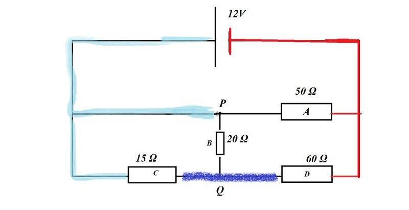

To make what Steve said a bit more graphical and since I was working on it anyway:
All of the wires in the same colour has the same potential. You can redraw the circuit as you wish without changing the currents through the resistors as long as the resistors connect to the same colours as in the original diagram.
You mean here:
The current through the first branch is 12/50 A = 0.24A and the current through the last branch is 12/15A which is 0.8A
And the total current is I=0.24A+0.8A=1.04A ?
Pouyan said:
And you mean the same current is passing through those areas ?
No. The left side of A, the left side of C, and the top of B are points, not 'areas'. They are all directly connected together by (ideal) wire so they are at the same potential as the postive cell terminal. The current from the positive terminal of the cell will split into 3 currents (through A, B and C) which are probably different.
But you are missing the point. I'm suggesting you try to redraw the circuit with the resistors in different poisitions. Then you can see you have some simple series and parallel arrangements which are easy to calculate.

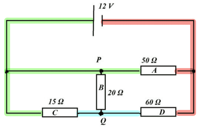

Orodruin said:
Another useful tool when redrawing circuits is to note that if there is a wire in the circuit that is only connecting two other wires (i.e., no component on its end) - then that wire can be contracted to a point with the two nodes it was connecting becoming a single node. You have one such occurrence in your diagram.
In the right part of A and D which is red; well the current to the left part of A is (12/50)A=0.24A
and the same for D is (12/60)A= 0.2A
The sum of these currents are 0.44A. Because A and D are parallel the R_AD = 300/11 Ohm; and 0.44 * 300/11 V = 12V.
But is the current in the left part of A 12/50 Ampere as well?!
And the current through the left part of Rc, I see 12/15 A = 0.8 A !
I see that the potential at P is 12V am I right?
But what is the current in the right side of Rc?
Pouyan said:
Because and D are parallel ...
A and D are not in parallel. To be in parallel, each pair of ends must be directly joined.
The right-end of A is joined to the right-end of D (so they are the same potential). Fine.
But the left-end of A is not joined to the left-end of D. Resistor B is 'in the way'.
So A and D are not in parallel.

##R_B## and ##R_C## are in parallel. So calculate ##R_{BC}## from that.
Then ##R_{BC}## and ##R_D## are in series. So calculate## R_{BCD}## from that.
Then ##R_A## and ##R_{BCD}## are in parallel.
Likes Steve4Physics and Pouyan
Thanks!
$$R_{BC} =\frac{60}{7}\Omega $$
$$R_{BCD}=68.57\Omega$$
The total $$R=29\Omega$$

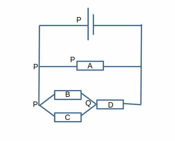

Hi @Pouyan. I probably shouldn’t have, but here’s your circuit re-drawn to make it easier for you to see what’s going on.
It is worth your time to check carefully, so that you understand why all the connections are exactly the same as in your original circuit.
For information I’ve marked point P at 4 different positions. That’s because these points are all directly connected by (zero resistance) conductor and therefore are electrically identical.
This is exactly the same circuit as yours, but I hope you can now see the series and the parallel groupings.
Have you met the ‘potential divider formula’? If you can use it, there is no need to find the total resistance or any currents. 12V is being divided between ##R_{BC}## and ##R_D## and finding ##V_{PQ}## is a short/simple calculation.

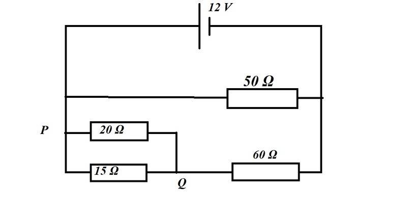

@Delta2 , Steve4Physics, Orodruin
I'm done!
Now I know that I could draw the scheme just like this:
$$\frac{1}{R_{Left}}=\frac{1}{20\Omega }+\frac{1}{15\Omega }$$
$$R_{Left}=\frac{60}{7}\Omega $$
Together with the right R that is 60 Ohm:
$$R_{down}= \frac{60}{7}\Omega + 60\Omega $$
Parallell with the upper resistor that is 50 Ohm, the total R, $$R_{total}=28.29\Omega $$
The total current $$ I_{total}= \frac{12}{28.92}A$$ =0.415 A

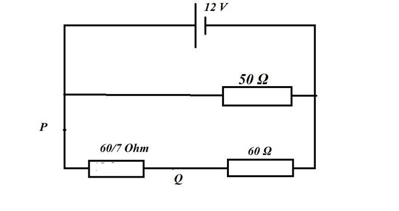

The current in the middle resistor is 12/50 A=0.24A
I redraw the bottom part. The current here is 0.175 A. The voltage at the right resistor is 60*0.175 V = 10.5V
and the voltage at the left side is 1.5 V that is between P and Q...
The hardest part was that I did not know that I could redraw the points P and Q, it made the task much easier for me. :smile:

Just to comment that you are taking a long way around when you compute the total resistance and total current. All you need is the current through the lower branch and consequently how the potential drop distributes over that line. You can completely ignore the 50 Ohm resistor. The result would be the same regardless of the resistance in that line.

For a quicker method, you can apply the potential divider formula (look it up if interested) to ##R_{BC}## and ##R_D##. This gives:$$V_{PQ} = 12 \times \frac {60/7}{(60/7 + 60)} = 12 \times 0.125 = 1.5V$$ For this particular problem, it saves you working out the total resistance and any currents.
