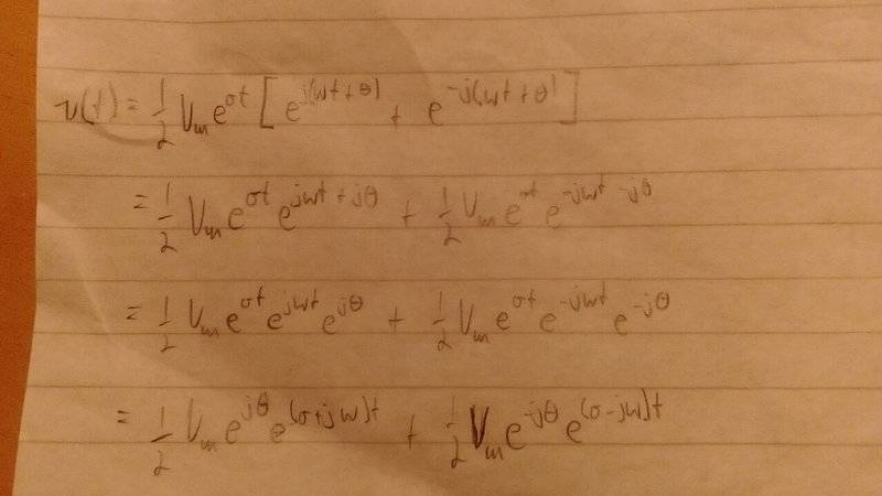

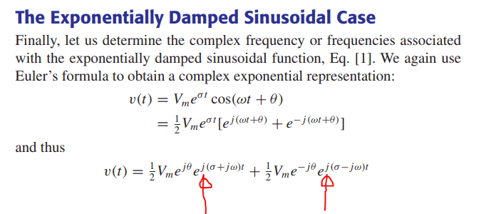

From Hayt "Engineering Circuit Analysis". I'm just wondering how the imaginary "j" multipliers appeared.
I think that the "magic" involved was a printer's error. Looks like a typo in the text to me.
