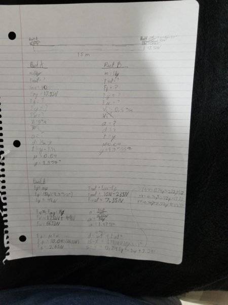

Two pucks (5 kg each) made of Teflon are on a long table, also made of Teflon. Puck A is sitting at
rest on the left end of the table. Puck B is 15 m away at the right hand end of the table, and is
travelling toward Puck A with an initial speed of 0.5 m/s. A person on the left waits 1.5 seconds and
then pushes Puck A forward from rest with a force of 20 N applied at an angle of 30° to the horizontal.
If that force is maintained at a steady rate for the entire question, how far will puck A travel before it
strikes puck B? (The coefficient of friction between the Teflon and Teflon is 0.04.
2. The attempt at a solution:
Puck A
Fax = 20NSin30
Fax = 10N
Fay = 20NCos30
Fay = 17.32N
Fg = mg
Fg = (5kg)(9.8m/s^2)
Fg = 49N
Fn = Fay + Fg
Fn =17.32N + 49N
Fn = 66.32
Ff = uFn
Ff = (0.04)(66.32N)
Ff = 2.65
Fnet = Fax - Ff
Fnet = 10N - 2.65
Fnet = 7.35N
a = Fnet/m
a = 7.35N/5kg
a = 1.47m/s^2
d = v1t + 1/2at^2
15-x = 1/2(1.47)(y-1.5)^24
x = -0.74y^2 + 2.22y +13.33

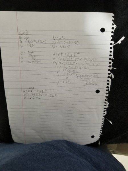

Puck B
Fg = mg
Fg = 49N
Ff = uFn
Ff = (0.04)(49N)
Ff = 1.96N
Since there is no applied force Fnet = -Ff
a = Fnet/m
a = -1.96/5kg
a = -0.39m/s^2
d = v1t + 1/2at^2
x = (0.5)(y) + 1/2(-0.39)(y)^2
-0.74y^2 + 2.22y +13.33 = 0.5 - 0.195y^2
0 = 0.545y^2 - 1.72y-13.33
I then put it in the quadratic formula and got:
y = 6.77s and y = -3.61s(omited)
Puck A Distance
d = v1t + 1/2at^2
d = (0m/s)(6.77s-1.5s) + 1/2(1.47m/s^2)(6.77-1.5s)^2
d = 20.41m(This answer doesn't make sense)

Your "attempt at solution" is unreadable. Please type it out.
Your images are on your private google drive, so the links are inaccessible to other members. Either type out your solutions as suggested, or at least use the UPLOAD facility to make the images local to the PF server.

I uploaded the photos from a local source, so you should be able to see my work. Thank you for taking the time to help me.

Your work in the images is basically unreadable. You'll have to type in your work.

I typed out all the steps I used.
