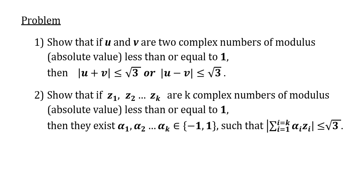

MHB Complex numbers such that modulus (absolute value) less than or equal to 1.
For complex numbers u = a + bi and v = c + di with moduli less than or equal to 1, it is established that a² + b² < 1 and c² + d² < 1. The sum u + v results in a modulus |u + v| that can be expressed as √(a² + b² + c² + d² + 2ac + 2bd), which is constrained by the inequality involving ac + bd. It is shown that if ac + bd is positive, then |u - v| is limited to √2, while if negative, |u + v| is also limited to √2. The discussion hints at a more complex problem that may require an inductive proof approach. The findings reinforce the relationships between the moduli of complex numbers within the unit circle.

Write u= a+ bi and v= c+ di. If modulus u and v are both less than 1 the $\sqrt{a^2+ b^2}< 1$ and $\sqrt{c^2+d^2}< 1$ so $a^2+ b^2< 1$ and $c^2+ d^2< 1$.
u+ v= (a+ c)+(b+ d)i. $|u+v|= \sqrt{(a+ c)^2+ (b+ d)^2}=$$\sqrt{a^2+ 2ac+ c^2+ b^2+ 2bd+ d^2}= $$ \sqrt{(a^2+ b^2)+ (c^2+ d^2)+ (2ac+2bd)}< \sqrt{1+ 1+ 2(ac+ bd)}< \sqrt{2+ 2(ac+ bs)}$
Can you prove that $ac+ bd$ is less than 1/2?
Following up on Country Boy's calculation, notice that if $v$ is replaced by $-v$ then $b$ becomes $-b$ and $d$ becomes $-d$. Therefore $$|u+v| \leqslant \sqrt{2+2(ac+bd)}, \qquad |u-v| \leqslant \sqrt{2-2(ac+bd)}.$$ It follows that if $ac+bd>0$ then $|u-v| \leqslant\sqrt2$, and if $ac+bd<0$ then $|u+v|\leqslant\sqrt2$. That proves 1). (In fact it proves a stronger result, with $\sqrt2$ instead of $\sqrt3$.)
Problem 2) seems to be a lot harder. I found a sketch here of how to prove it by induction (again with $\sqrt2$ rather than $\sqrt3$).
