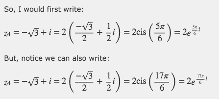

If possible, i was wondering if you could explain how $$ z4 = -\sqrt{3} + i $$ can be written in two different ways as you have shown below. I don't understand this step. Many thanks.

Well, what I did was found $0\le \theta<2\pi$ such that:
$$\text{cis}(\theta)=\frac{-\sqrt{3}}{2}+\frac{1}{2}i$$
And then we use the periodicity of the cis() function:
$$\text{cis}(\theta+2k\pi)=\text{cis}(\theta)$$ where $$k\in\mathbb{Z}$$
To find the solution in the next cycle ($k=1$), so that we have two arguments in $0\le\theta<4\pi$...because when we reduce the argument by dividing by 2 when we solve for $z$, we will have two arguments in $0\le\theta<2\pi$.
Does that make sense?

Yes with that explanation and also revisiting the textbook this is starting to make sense now. Thanks so much, you've been so helpful!
