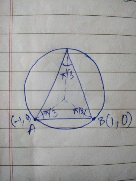

Show that arg[(z-1)/(z+1)] represents a circle. Find it's radius and centre.
using z = (x+iy) i narrowed down to (z-1)/(z+1) = (iy)/(1+x) , assuming it was a circle.

So there is something missing from the problem statement.Generally: $$\frac{z-z_1}{z-z_2}=c$$... is a circle in the complex plane if c ≠ 1 and is real.
... overall you need to think how the argument comes into this.
Note: C=r is the equation of a circle, radius r, with it's center at (x,y)=(1,0).
If A=arg[C] then the radius of the circle is r=√tan(A/2).
... depending on how the argument is defined in your course.

So if we consider A(-1,0) and B(1,0) to be 2 points on the argand plane and z be any arbitrary point then line segment zA will be z+1 and zB will be z-1. The arguments will be arg(z+1) and arg(z-1) respectively. So the angle between the 2 lines will be arg((z-1)/z+1)). We have been given that this angle is constant(π/2). We know that any angle subtended by the end points of a chord on a circle is always equal. So we know that locus of z is a circle.
The center can be found out be taking the incenter of an equilateral triangle(one of the many possibilities of triangle zAB)whose base is AB and radius will be the distance from this point to any of the 2 points(A or B)
Hope this was helpfull:smile:

I cannot see why you "simplify" the way you do. To convert(z-1)/(z+1) to X + iY form you need to multiply and divide by (x+1-iy), not the (x-1 - iy) that you used. I get
$$\frac{z-1}{z+1} = \frac{x^2+y^2-1 + i 2y}{x^2+y^2+2x+1}.$$
