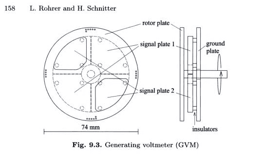

The 1pF capacitance is not a component of the amplifier but it is part of the detector, called a Generating Volt Meter (GVM). It is basically a parallel plate capacitor with an area of a few square inches and a distance of over a meter! it might be closer to .1pF. Attached is an illustration of the GVM, which shows that its not an AC voltage coupled by a fixed capacitance. Instead it is a fixed voltage and the capacitance is varied by blocking the electric field with a spinning grounded rotor.

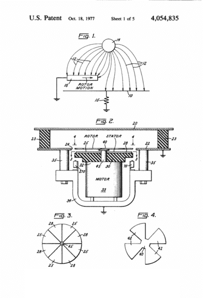

That's an interesting project.
Hobbyists use a similar gizmo to measure Earth's electric field, it's on my "Do List"
here's old Scientific American article
i have seen more detailed article someplace, will try to find it and see what electronics they used. He just says "transconductance amplifier".
I improvised a field mill by taking two steel cake pans and cutting out a dozen equally spaced 15-degree wedges (the slots) from their circular bases. To rotate one of the pans, I used a surplus high-speed electric motor. These motors typically deliver between 1,000 and 7,000 revolutions per minute. At those rates and with the cake pans cut with 15-degree wedges, the Earth's field generates nanoampere-size current surges in the ground wire at frequencies between 200 hertz (for 1,000 rpm) and 1,400 hertz (for 7,000 rpm). Such a signal can be observed easily with a circuit containing a transconductance amplifier and a peak detector. In fact, my homemade instrument can readily detect shifts a mere thousandth of the ambient field. Furthermore, a computer analyzing the data will be able to follow the fluctuations with a performance rivaling that of professional instruments.
http://www.scientificamerican.com/article.cfm?id=detecting-the-Earth's-elec

Oh man that is so cool! exactly the same principle. I bet it the E field goes crazy during a thunderstorm. I wish mine went at 1400 hertz because then my software could calculate the voltage faster.
