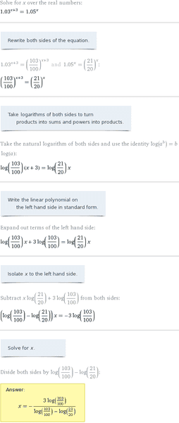

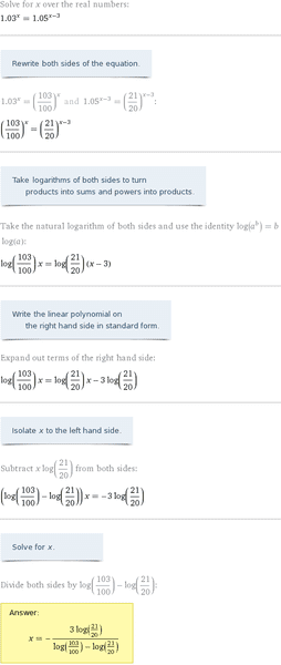

Deciding how to create my formula is where things get fuzzy. The way I initially attempted this was to add a 3 year head start onto Romeo's interest formula. This is what results (Used wolfram to save time rewriting):
This eventually results in "4.61103." However, this is not the answer at the back of my textbook. They decided to opt for a different formula where the time is subtracted from Juliet's interest function. This is shown here:
This results in the correct answer of 7.61103. What I'm wondering, why do I have to subtract 3 years from Juliet's compound interest formula, and why does adding 3 years to Romeo's compound interest formula produce the wrong answer?
So clearly the book starts counting at the beginning of the story: when Romeo brings his money to the bank.
That means Julia's interest clock is at x-3 when Romeo's is at x.
What is Romeo's age when then two accounts have equal value?
Both answers agree.

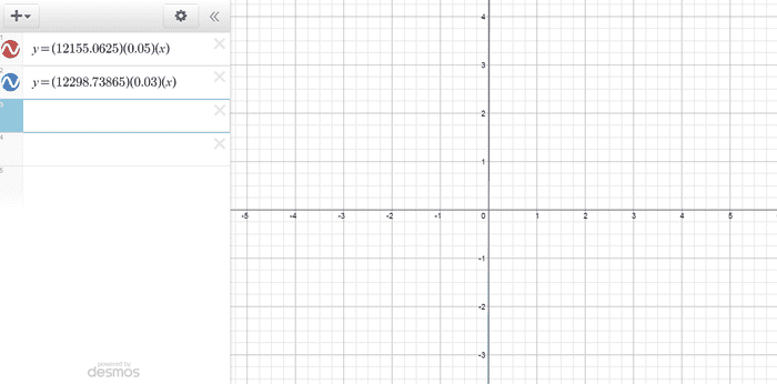

I am going to assume the two lines would be plotted as
y=(12155.0625)(0.05)(x)
and
y=(12298.73865)(0.03)(x)
If that's the case, I don't understand how any human being is supposed to find the point of intersect graphically like this.
I did sit down and do it. I have been sitting down and ripping my hair out doing this for sometime.
Edit - In the event that anyone else would like to question how committed I am to "sitting down and doing it." I've had enough of that nonsense from teachers with superiority issues and over bloated opinions that like to question how hard I am making an attempt.
and
As long as you persist in trying to plot the wrong thing you will need to keep pulling out your hair. Go back and read what I wrote in #12. Do the plot exactly as I indicated there.
Better still plot the two curves y = 10000 * (1.03)^x and y = 10000 * (1.05)^(x-3) for x = from 3 to 8. They are curved, aren't they? Don't they look almost straight over the shorter interval 7 \leq x \leq 8? in each case if you were to plot a straight line from (7,y(7)) to (8,y(8)) it would look very close to the actual curve (x,y(x)) for x between 7 and 8. The "simple interest" effect between 7 and 8 would be the straight line, while the "compound interest" effect would be the curve. They both pass through the same points at 7 and 8, but they differ in between.

I was on the right track here. There is no need for this graphing nonsense. I forgot a single number which was my "+ 3" in my simple interest formula. I was a fool not to recognize that the lack of a constant would render my simple interest system of equation unsolvable. The lack of anyone speaking up about this is worrisome. In the future, when referencing the slope of a secant line between the range of two x values of a curve, please write in the notation of 7 < x < 8. I had absolutely no clue what you were talking about.
So let's try that last bit again with a fixed formula.
Romeo Simple Interest Calculation
(Ir) = (12,298.73865)(0.03)(t+3)
(Ir) = (368.94)(t+3)
Juliet Simple Interest Calculation
(Ir) = (12,155.0625)(0.05)(t)
(Ir) = 607.753125(t)
Now the Systems of Equation
(607.753125)(t) = (368.94)(t+3)

Aj = 10,000(1.05)^4
Aj = 12,155.0625
(Ir) = (12,298.73865)(0.03)(t)
(Ir) = (368.94)(t)
Equate the two to equal each other.
(368.94)(t) = 607.753125(t)
(368.94)(t) -607.753125(t) = 0
t(368.94-607.753125)=0
This doesn't work though...
