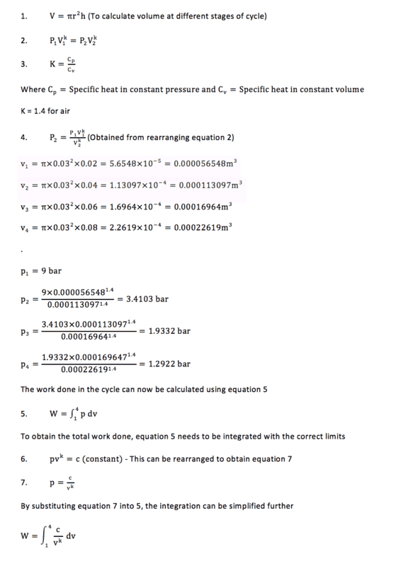

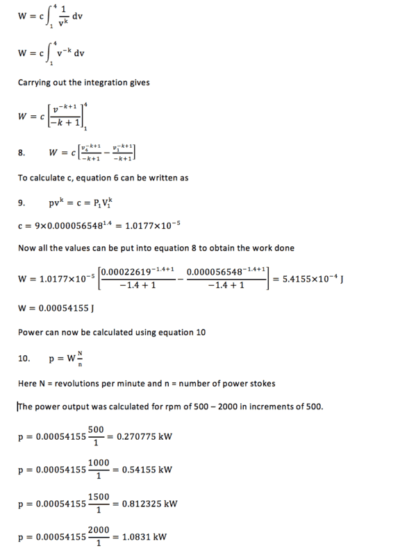

Hi, I posted a question a while ago which I have managed to do some more calculations for. I need a bit of help to see if they are correct. I am trying to obtain power and torque values at different rotational speeds of a single cylinder compressed air engine. The inlet pressure into the engine is a constant 9 bar and the air is discharged from the chamber as the piston reached BDC rather than a conventional cam valve design. My calculations below for power do no seem right compared to MATLAB and experimental results.
I have attached screenshot as it will not let me post equations into this.
I would like to get torque values at different rpms and also any formulas to calculate how quickly a air tank would empty at a specific rpm.
Much appreciate the help.
What sort of engine do you have in mind? Is it a reciprocating machine employing a slider-crank mechanism or a continuous flow machine like an air turbine? You need to tell us more about what you are contemplating before much can be said about your calcs.
It would like a reciprocating engine
You use of the constant k = 1.4 seems to imply an adiabatic expansion. In fact, it will be more nearly a polytropic expansion, k = 1.35 roughly.
The other problem I see is that you have assumed a very idealized cycle, with instantaneous fill and exhaust; this is not how it actually happens.
