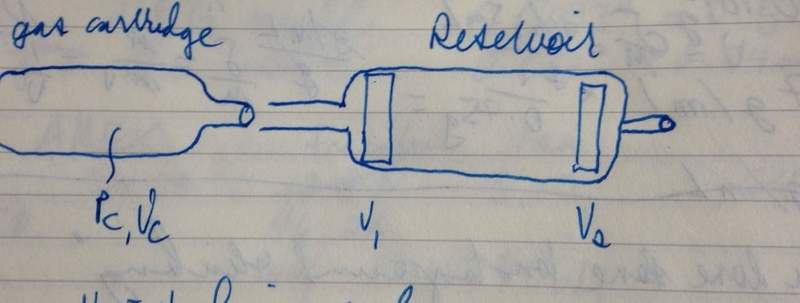

In summary, Folks, I'm new to this thread. I'm a mechanical engineer, but I haven't done much fluids work since I graduated, 20 years ago. I have a question about calculating gas flow rate, so any help would be greatly appreciated. I have a design that I'm working on that will use a compressed gas cylinder to push a plunger that pushes a fluid on the other side of the plunger out of a critical orifice. I need a very low constant pressure (about 1 psi), the cylinder manufacturers are telling me that I need a flow rate. I've told them that the gas will fill a chamber with a piston and the total volume of that chamber is 3 mL.

Folks, I'm new to this thread. I'm a mechanical engineer, but I haven't done much fluids work since I graduated, 20 years ago. I have a question about calculating gas flow rate, so any help would be greatly appreciated. I have a design that I'm working on that will use a compressed gas cylinder to push a plunger that pushes a fluid on the other side of the plunger out of a critical orifice. I need a very low constant pressure (about 1 psi), the cylinder manufacturers are telling me that I need a flow rate. I've told them that the gas will fill a chamber with a piston and the total volume of that chamber is 3 mL. This filling will occur over a period of 16 hours, so that flow rate is 0.188 mL/hr if it were a liquid. I'm not sure how if that's the flow rate they are looking for (and neither do they) since it's a compressed gas. Any ideas on a governing equation(s) that I can use.

So, I think I need to clarify, because the volume of the tank is changing. As you can see in the attachment, the volume of the reservoir changes as the fluid is pushed out of it and replaced by the gas. V1 is the initial volume where the fluid volume is maximum and the gas is minimum and V2 is the final volume where the fluid is empty and the gas volume is maximum. The reservoir total volume is 3 mL.

So what is controlling your flow rate?
You mentioned the liquid and a critical orifice - you also want a 1 psi pressure to force the liquid through the orifice. In that case, one option is to charge a large enough cartridge to 1 psi so that the increase in volume of gas into the reservoir does not change the initial pressure, keeping temperature constant for 16 hours.
The other option is to regulate the amount of air that enters into the reservoir regardless of cartridge pressure with something such as a very long small ID capillary tube, or something similar, whatever is the standard technology in industry or laboratory for such a low flowrate.
Thank you for your help, first of all.
The flow rate of the liquid is controlled by a critical orifice and the force pushing it. The temperature will be held constant throughout the process, so that's helpful. I have identified a cartridge that is charged at something like 800 psi and holds 075g of CO2, so I think that it's overkill, but I believe it will work. I'm not sure how I can control the flow rate, the problem is I don't have the space to use a regulator. I don't think I have the room for a long capillary tube, but maybe. Any other thoughts?
