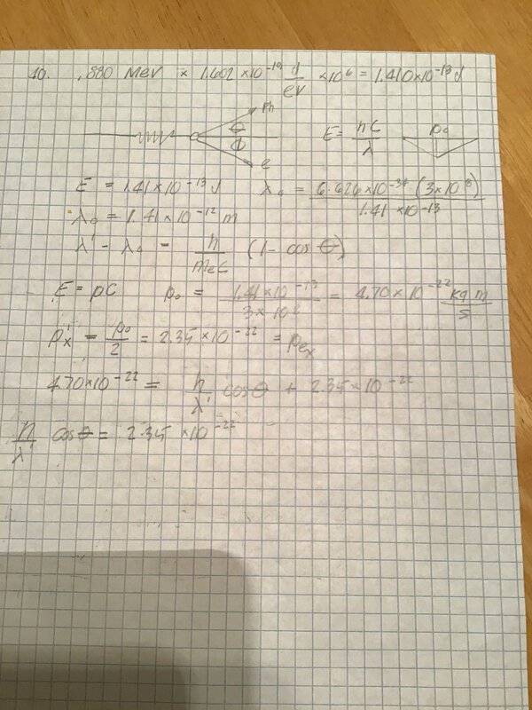

A 0.880 MeV photon is scattered by a free electron initially at rest such that the scattering angle of the scattered electron equals that of the scattered photon. (a) Determine the angles theta and phi. (b) Determine the energy and momentum of the scattered photon. (c) Determine the kinetic energy and momentum of the scattered electron.
See below
I don't follow what you are doing there. I wouldn't consider converting the energy of the photon from ##eV## to joules as a good start. How does that help?
The question says that the scattering angles are the same and asks you to find the angle. I can't see any attempt at finding this angle.
This problem looks quite advanced and certainly isn't an exercise in number crunching. I think you'll need a fair bit algebra for part (a).

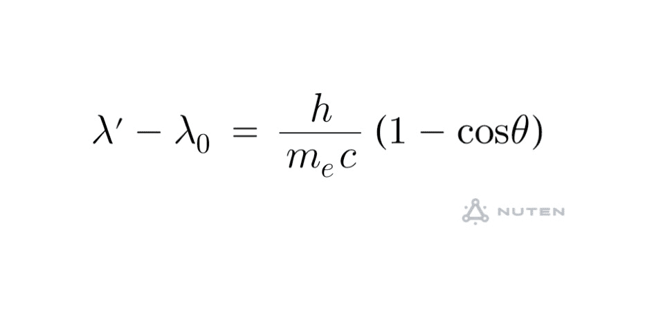

I did look at LaTeX but decided as a hobbyist, self studying, that I will stick with Nuten. I hope this isn’t too much of an inconvenience for the moderators whose feedback I appreciate very much.
The real issue for this problem is how you go about finding the common scattering angle. To do that, you need to manipulate the energy and momentum conservation laws and equations.
You need to write down the key equations and then solve for the required unknown quantities. Equations with symbols for energy and momentum are preferred.
Hint: you don't need Planck's constant for this. And, although you could use the Compton formula, I'm not sure it makes things any simpler. I suggest treating this like a standard scattering problem.

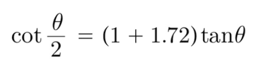

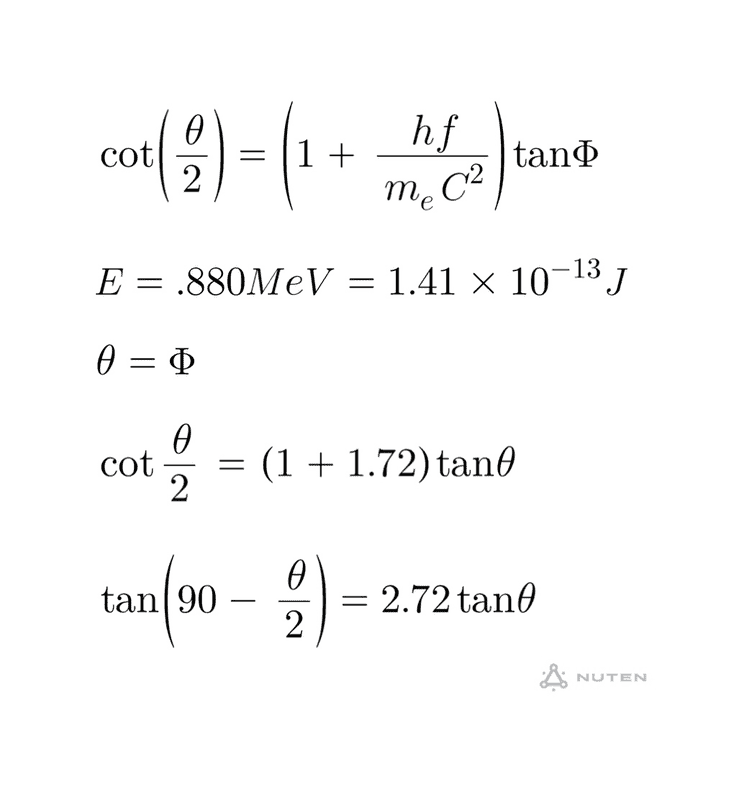

I think the intent is to solve the problem with conservation laws which I won’t be able to do. I tried to solve the formula below that I found in a related thread but got stuck.
In general, you seem to be able to put numbers into a single equation. That means you need someone else to solve the problem for you and provide you with that single equation.
To solve the problem yourself you must combine and manipulate several equations to get the new equation you need. Looking at your homework posts in general, that doesn't seem to be something you do.
There's not a lot we can do to help until you learn to manipulate equations for yourself.

Yes - perhaps I did too much of the work for the OP here and he would indeed have to show where the equation came from before using it. Digging around you don't seem to find much on the calculation of ##\phi## but a more general purpose equation which can easily be derived from the standard Compton scattering vector diagram is the following: $$ \tan\phi=\frac{E_2\sin\theta_d}{E_1-E_2\cos\theta_d} $$ where ##E_1## and ##E_2## are the energies of the incident and scattered photons respectively and ##\theta_d## is the angle of deflection.
Another point which has been emphasised in previous threads in that really the energy form of the Compton scattering equation should be recommended - ie: $$1-cos\theta_d=E_0\left(\frac{1}{E_2}-\frac{1}{E_1}\right)$$
Let ##t=\tan\left(\frac{\theta}{2}\right)## and write everything in terms of t.
