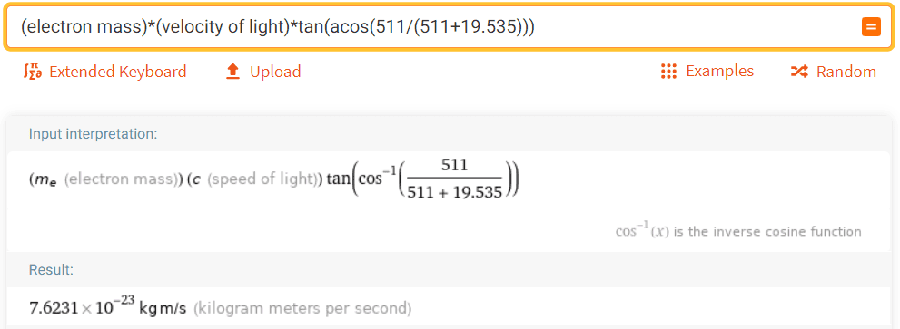

I got 7.623 x 10-23, three different ways, using an extra couple of digits in c, h, and me, and making sure not to round off intermediate results. Slightly different values for those constants probably explain the difference between us two. I think whoever wrote the problem had a bit of roundoff error.

Agreed - same result per following:
