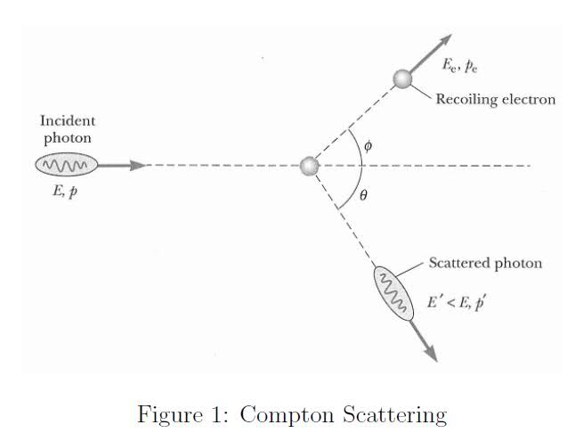

Gamma rays of energy 1.02 MeV are scattered from electrons that are initially at rest. If the
scattering is symmetric, that is, if θ = ϕ in Fig. 1, find
i. the scattering angle θ
ii. the energy of the scattered photons.

I'm using the same angle because the problem states that "the scattering is symmetric, that is, θ = ϕ in Fig. 1". Am I interpreting this part incorrectly?
