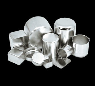

I'm not sure if it fits your requirements, but you could do some simulations and optimizations of magnetic shielding using the combination of netic and co-netic mu-metal shield materials. Magnetic Shield Corporation has lots of information about shielding materials and applications:
https://www.magnetic-shield.com/
https://www.magnetic-shield.com/all-about-shielding-faqs/
https://www.magnetic-shield.com/material-types/

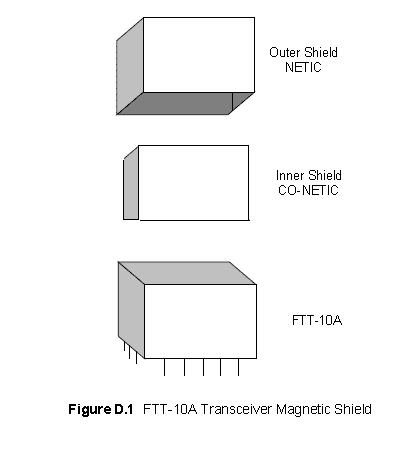

The two materials are used in combination with one material surrounding the other to optimize the magnetic shielding effect. The highest mu material does the best job of shielding, but saturates if it is not thick enough. Adding the lower mu material in a laminate fashion helps to optimize the overall thickness and cost of the shield.
We use such shielding in a product that has sold in high volume -- it is an electronic device that is about a cubic inch in size and can be placed in pretty magnetically noisy environments (like next to switching power supplies with open magnetics). We had Magnetic Shield Corporation help us to design a nested pair of 5-sided shield cups that fit over our product.
You could do your simulations with various choices of netic and co-netic materials and different thicknesses to show how to optimize the shield combination for cost and thickness... :smile:
