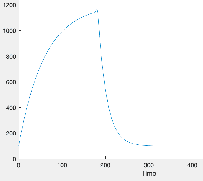

For the first, I have to determine alpha and beta. Beta is obviously 5, and I thought alpha is 1/20, thus 0.05. I am not sure if this is true since the assignment states that the protein does not degrade. Forgive me, I am not that into biology. So the steady state should be 5/0.05 = 100.
I am not sure how to do that with the time shift. I tried to plot it and see how it is looking, so I let MatLab solve the differential equation stated above with initial condition 100. When t is below 180 (3 hours) I set beta to 20 and alpha to 1/60. And when t is higher than 180 then I set the parameters as before. However, that looks like the following:
Unfortunately, I don't know how to calculate the dynamic level of protein X starting with t=0, that's the main problem which I also need for 3.
For 3 I've no idea currently.
I appreciate any help!

You could at least calculate the nM for the second steady-state and third steady states in the same kind of way independent of your simulations as a check.

Thanks a lot for your reply. Oh yes, Y is X, sorry. The book denotes it as Y and the assignment as X. The second steady state would then be 1200, however, I'm not sure if my simulation is ok, looks weird to me. To be honest, I am not really able to provide you more background, it is just a "simple transcriptional process". Perhaps you may like to take a look at the book (pdf), ~page 18: https://www.google.com/url?sa=t&rct...cedownload=1&usg=AOvVaw0vBzFeIJ3J9W7Lbe2sU4BK

Maybe a more arithmetic rather than formulaic reasoning would tell you if your steady states are right and reasonable.
I see the model is different from what I imagined, It is essential to know what the model is!
Now I know that your second steady state looks right to me.
As well as Matlab, your text at that point tells you the solution of this standard and elementary differential equation, so you can also calculate it that way.

When a cell divides it splits its contents between two cells. So it there were 100 molecules in the parental cell, each daughter cell will have 50 molecules. Alternatively, you can think of cell division as dilution; the cells are growing in volume, such that the total volume doubles every 20 min. If the initial concentration of Xwas 100nM, and no X is being synthesized, the concentration of X will be 50nM after 20min.
Essentially, you can treat the cell division time as a halflife.
