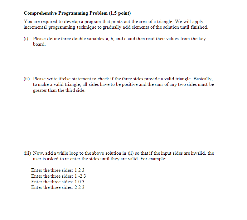

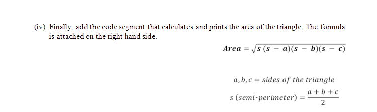

compute the area of a triangle. write an if/else statement to check if the three sides provide a valid triangle. to make a valid triangle, all sides have to be positive and the sum of any two sides must be greater than the third. add a while loop so that if the sides are invalid the user is asked to re enter the sides.
Code:
#include <iostream>
#include <cmath>
using namespace std;
int main() {
double a=0,b=0,c=0;
cin >>a>>b>>c;
double A=0;
double s=0;
s=(a+b+c)/2;
A=sqrt(s*(s-a)*(s-b)*(s-c));
if(((a>0)&&(b>0)&&(c>0))&&(((a+b)>c)&&((a+c)>b)&&((b+c)>a))) {
    while(!(a<=0||b<=0||c<=0||(a+b)<=0||(a+c)<=0||(b+c)<=0))
    cout << A;
else
cout << "Error.";
this is what i wrote. is it correct? i compiled it on this site Compile and Execute C++ online i don't know if you can see my code if not you can just copy and paste it there. at the bottom of the page it says STDIN Input. you can enter sides to test it. just leave a space between them (i.e. 3 8 -2). this question will be brought on our midterm so i want to make sure i did it absolutely correct now and that no errors slip past me.

First, you should write the complete problem statement. I see that you tried a negative number as a side length, so I assume your program has to take into account that input numbers may not represent side lengths of an actual triangle. A program that tests for such inputs is different from a program that expects correct lengths. What checks exactly do you need to make? Also, you should write the problem statement in the body and not in the title as described in rule #10 http://mathhelpboards.com/rules/.
It is not clear to me why you used the [m]while[/m] loop. This loop is used when some calculation have to be done repeatedly (and usually when the number of iterations is not known in advance). In this problem, there are no iterations; the number of operations it takes to find the area is known in advance.
You should test whether the triangle inequality holds before taking the square root in the calculation of $A$. For example, if $a=1$, $b=2$ and $c=5$ we have that $a+b>c$ does not hold, but $a+c>b$ and $b+c>a$ do hold. Meanwhile,
s-c=\frac{a+b+c}{2}-c=\frac{a+b-c}{2}<0
for these $a$, $b$ and $c$. Similar calculations show that $s-a>0$ and $s-b>0$, so $s(s-a)(s-b)(s-c)<0$ and taking the square root will through an error. Checking that the triangle inequalities hold will guarantee that the expression under the square root is positive.

While I am flattered, it really isn't a matter of kindness, but rather of efficiency of coding. Also, I made a boo-boo, we want to make sure the radicand in [m]A[/m] is greater than zero.
Let's look at:
\(\displaystyle s(s-a)(s-b)(s-c)>0\)
Since \(\displaystyle s=\frac{a+b+c}{2}\), this becomes:
\(\displaystyle \frac{a+b+c}{2}\left(\frac{a+b+c}{2}-a\right)\left(\frac{a+b+c}{2}-b\right)\left(\frac{a+b+c}{2}-c\right)>0\)
\(\displaystyle \frac{a+b+c}{2}\left(\frac{b+c-a}{2}\right)\left(\frac{a+c-b}{2}\right)\left(\frac{a+b-c}{2}\right)>0\)
\(\displaystyle \frac{1}{16}(a+b+c)(a+b-c)(a+c-b)(b+c-a)>0\)
Now, you have checked to make certain that [m](a > 0) && (b > 0) && (c > 0)[/m] so we only need:
\(\displaystyle (a+b-c)(a+c-b)(b+c-a)>0\)
And so, I was completely wrong when I first looked at your code, you are in fact testing the right conditions. (Wasntme)
But, I still think it is more efficient to write something like:
Code:
s = (a + b + c)/2;
r = s*(s - a)*(s - b)*(s - c);
if ((a > 0) && (b > 0) && (c > 0) && (r > 0))
    A = sqrt(r);
    cout << A;
else
    cout << "Error.";
You see, this way, we only invoke the [m]sqrt()[/m] function once we are sure an internal error won't be thrown by potentially trying to use a radicand that is not positive.

ill fix the title. my instructor says we have to use a while loop so that if the input sides are invalid the user is asked to re enter the sides until they are valid. (i know i missed that part where i ask the user the re enter sides)
i fixed the title. I am going to add something to the while loop now that i missed.
