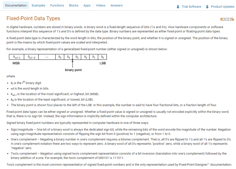

Assuming you mean Fixed Point and not Floating Point, what data representation are you supposed to use for this problem?
https://www.mathworks.com/help/fixedpoint/ug/fixed-point-data-types_btb4ld0-1.html
The problem states "double precision" which is floating point, specifically it is the binary64 implementation of IEEE754: https://en.wikipedia.org/wiki/Double-precision_floating-point_format.
