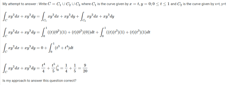

##f(x,y) =xy^2i + xy^3 j ; ## C: the ploygonal path from (0,0) to (1,0) to (0,1) to (0,0)
None
Please refrain from posting your work as images. Even if legible (which it hardly is on my phone without zooming in) it is impossible to quote properly. Instead use the built-in LaTeX functions and type your work.
That said, you have not specified ##C_3## and your ##C_2## does not correspond to any part of the desired curve.

The integral for ##C_3## should be zero, still you should 've said that explicitly.
I think your parameterization ##x=t,y=t## for ##C_2## is wrong (according to that parameterization the point (1,1) for t=1 belongs to the path, but we know it does NOT), I think the correct one is ##x=t,y=1-t##.

Write ##C = C_1 \cup C_2 \cup C_3## where C1 is the curve given by x = t, y =0, 0≤t≤1 , C2 is the curve given by x= (1-t), y =t, 0≤ t ≤1, and C3 is the curve given by x=0, y = 1-t, 0≤ t≤ 1. Then,
## \displaystyle\int_C xy^2 dx +xy^3 dy= \displaystyle\int_{C_1} xy^2 dx + xy^3 dy + \displaystyle\int_{C_2}xy^2 dx +xy^3 dy + \displaystyle\int_{C_3}xy^2 dx + xy^3 dy ##
## \displaystyle\int_C xy^2 dx +xy^3 dy = \displaystyle\int_0^1 t(0^2)(1) + t(0^3)(0) dt + \displaystyle\int_0^1(1-t)(t^2)(-1) + (1-t)(t^3)(1) dt + \displaystyle\int_0^1 0 (0^2) 0 + 0(0^3)0dt##
## \displaystyle\int_C xy^2 dx +xy^3 dy = 0 +\displaystyle\int_0^1 -t^2 +2t^3 -t^4 dt +0##
## \displaystyle\int_C xy^2 dx +xy^3 dy = -\frac{t^3}{3} + 2\frac{t^4}{4} - \frac{t^5}{5} \big|_0^1##
## \displaystyle\int_C xy^2 dx +xy^3 dy = -\frac13 +\frac12 -\frac15 =-\frac{1}{30}##
Is this answer correct?
If correct, why is the answer negative? What does this negative answer indicate?
Yes it seems correct to me
You should be able to infer what the negative sign means. When does the dot product ##\mathbf{f}\cdot\mathbf{dr}## becomes negative?
Yes.

That you went backwards, in a sense.
