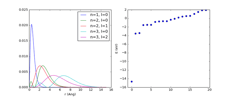

Ok, so I think I figured this out. I tried my code on the hydrogen atom problem and managed to map the functions to the known orbitals, so that clarifies things a bit. Pic incoming:
So what's happening here is we have eigenvectors for the 5 lowest energy solutions I found plus eigenvalues for the first 20 on the right. I've checked against analytical formulations and the orbitals match decently (with the obvious issues of precision). Here's the general approach I used:
  1. I computed the solution to the above mentioned equation for values of ##l## ranging from 0 to 5. Each channel gives me a number of solutions (in my case, 800, since that's the size of the grid I used); let's index them with ##i## starting from 1;
  2. I sorted the solutions by energy;
  3. In the plot on the left, the value of ##l## is of course the one employed for the given channel; the value of ##n## though is in fact ##n=l+i##;
  4. As it can be seen in the plot on the right the states are roughly degenerate; we first have one dot for 1s, then two for 2s, 2p, and so on; numerical precision issues ruin the pattern pretty quickly though.
Basically what I got is that when I solve for ##l=0## I do in fact get all s orbitals, when I solve for ##l=1## I get all p orbitals, and so on. This means that the first solution for ##l=1##, namely ##l=1, i=1## is in fact the 2p orbital; and so on.
So I think applying the same approach everywhere else should be fine, though precision is tricky (I'm using an existing algorithm as I mentioned but perhaps I can find one with better basis sets as @A. Neumaier suggested). What happens in non-Coulomb cases, as long as there are bound states, is simply that the so called 'accidental degeneracy' is removed.
