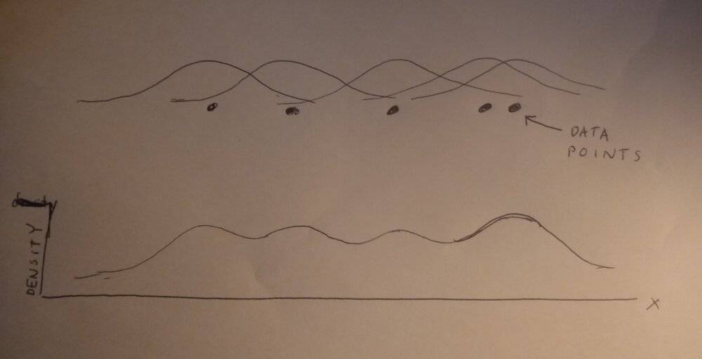

I have a point cloud representing broken bonds and I would like to represent the density of the cloud at some location in space.
Hi. For some background, I am running molecular dynamics simulations of silica fracture in LAMMPS. Each point represents the location of a broken bond. I would like to find regions where many bonds are breaking, which I speculate would be locations of crack formation. These computations are being done on MATLAB using data from the LAMMPS simulation.
I could come up with a way to compute the density. For example, I could sum the inverse of the distance from a specified location and each point. The sum would represent the density at that specified location. However, I was wondering if there was some standard and simple way of computing density of a point cloud, or one which would be particularly relevant considering the application. Thank you!

What if we represent each point by an impulse (##\delta##) as discussed above, but then you convolve (smear out) these impulses with a fairly wide gaussian -- wide enough to span a large number of points? This would give you a smoothed out function that would reflect the neighborhood density, but it won't get kicked up by individual points.
Simply put, a kind of 3-D running average with gaussian window. But since each data point has the same magnitude, the running average could easily be scaled to tell us the density.

I'm not sure if I fully understand, but I take it that I would represent each data point with a gaussian, then take the sum (scaling it to find the density). This would give a function representing the density at each point in space. Here's what I'm imagining in one dimension:
I imagine this would work very well, and it wouldn't blow up around the point. It would also be more continuous than my nearest neighbor approach.
Yes, that's the idea.
OK, I think this would be the calculation then. I'm going to do it for the 2-dimensional case. ##s## will be a parameter which can be adjusted to change how fine-grained the distribution is.
First I would compute the integral of the function so I can normalize it:
$$\int_{-\infty}^{\infty}\int_{-\infty}^{\infty}e^{\frac{-x^2-y^2}{s^2}}dxdy=\pi s^2$$
Then, the density would be the following:
$$d(x,y)=\frac{1}{\pi s^2}\sum_i e^{\frac{-(x-x_i)^2-(y-y_i)^2}{s^2}}$$

This might be an overly vague question, but which more method would be more accepted/ more physically meaningful/ more straight-forward/ less likely to run into issues/ overall better? I think an issue with using the range method is there are jumps when points come into range, which show up as faint rings around the point. However, I think what the value represents is a bit more straight-forward than for the gaussian method.
There are tools that do this smearing as it is a standard approach, and they also choose the width of the Gaussian for each point based on the local density of points (denser points -> smaller width to be more sensitive to local changes in the density). I don't know if the latter is done recursively or with other methods. You want the width to be larger than the typical separation so you are not too sensitive to individual entries, but it shouldn't be too much larger, otherwise you are blurring the overall distribution.

I wrote it on MATLAB, and it seems to work very well, clearly indicating where the crack formed. I think it will also be much easier to analyze than the number of neighbors function because it's continuous. If this is a standard approach, I think it definitely makes sense to use it for analysis.
