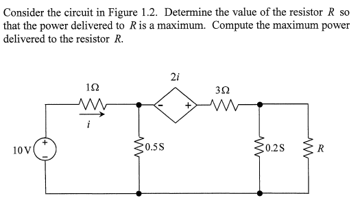

Computing the Maximum Power delivered to a Resistor
In summary, the person was taught that to find the maximum power, they need to find the Thevenin resistance and voltage. They used mesh analysis to solve for current, voltage, and impedance. They found that the i3 = -1/80 A. However, this is evidently wrong.

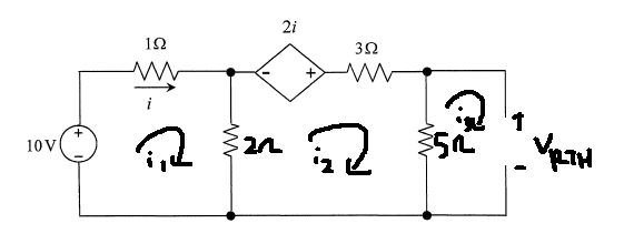

Hi all,
Checking my answers here as it doesn't seem to match with the answers given to me. Would appreciate if anyone could point out the mistakes I made.

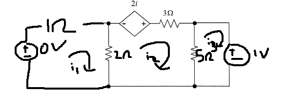

First I will compute Rth. Offing all independent sources, applying a known voltage across R (in this case 1v) and using mesh analysis,
2i1+0 (since i =0) + 3i1+5(i1-i2) = 0
10i1=5i2
5i1=2.5i2 -- Equation 1
2nd Loop:
5(i2-i1)+1 =0
Combing this with equation 1,
5i2 - 2.5i2 +1 =0
i2 = -0.4A
Hence Rth = 1/0.4 = 2.5 ohms.
Note: For Rth, the answer stated was 1.92ohms using nodal analysis.
Now to find Vth, I will just use normal mesh analysis for the normal circuit:
Mesh 1:
=-10+i1+2(i1-i2)=0 --> -10+3i1-2i2=0 --> **2i2 = 10+3i1**
Mesh 2:
2(i2-i1) - 2i1 +3i2+5(i2-i3) =0 --> **i1 = (-10i2+5i3)/4**
Mesh 3:
5(i3-i2)+Vr= 0 --> Vr= 5i2-5i3
Around whole loop:
=-10+i1-2i1+3i2+Vr=0 --> Using Mesh 3 equation, **i1=8i2-5i3-10**
Solving these 3 equations, i3 = 0.5A, i2 = 1.25A
Hence Vrth = 5( 1.25- 0.5) = 3.75V
Pmax =(Vrth^2)/4Rth = 1.40W?
Thanks.
You don't remove those sources, you set them to zero. Voltage sources intrinsically have zero impedance, since if you inject a finite current through them their voltage doesn't change, like a zero ohm resistor. Current sources have intrinsically infinite impedance, since if you inject a finite voltage across them the current doesn't change, like an infinite resistor.
So, a 0V independent voltage source is the same as a short circuit. A 0A independent current source is the same as an open circuit.
Ah okay. But what I did in my working was also simply setting them to zero, isn't it? Why will the solution be wrong here?
Sorry, I just didn't follow why you want to find Rth, or even what it is. Thevenin resistance, I guess, but which one, where? I'm not saying your approach is wrong, I'm saying I didn't follow it. A combination of my laziness, confusion because of some mistake you made early on, and perhaps a lack of a clear definition of what process you are following.
My approach would be different. To start with, what is the current in the 2 ohm resistor? Can you solve for i, just looking at the left-most loop?
edit: sorry I skipped your question: No you didn't set the INDEPENDENT sources to zero, you removed them. Refer to my previous comment. Then you concluded that the dependent source (=2i) was zero. Perhaps you should rethink that part.
Frankly, I don't really understand why your setting anything to zero. This circuit can be analyzed as it is using KCL and KVL. The source transformation theorems (Thevenin, etc.) should be used to simplify problems, not applied always, not if they make things more complicated.
Your solution is wrong because you have made mistakes in the analysis.

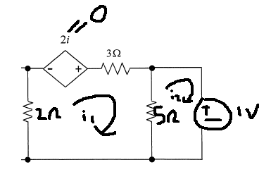

I was taught that to compute maximum power, I will need to find out the Thevenin resistance and voltage. To find Thevenin resistance, I will need to off any independent sources, and then use any form of circuit analysis to solve for the Thevenin resistance
Since it (the voltage source) is set to 0,
I then again use mesh analysis to solve for i1, 2 and 3, and found that i3 = -1/80 A. (which is evidently wrong).
May I know if the approach I am taught is wrong? or..?
OK, that method will work. I don't think it makes the problem any easier though.
So, using your method, how will you find Rth? You've already described an approach, but I don't think you've actually done it correctly yet. You will want to simplify the problem by finding out what you can about the dependent current source. Again, what is the current in the 2 ohm resistor?
Hint: because the confusing part of the circuit is a current source, using KCL may be helpful.
Note that the circuit contains a dependent voltage source, not a dependent current source.
