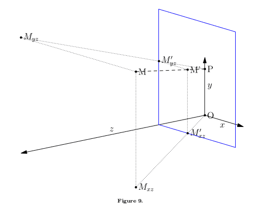

Using the attached figure for notation.
I found a circle of equation:

Then I define an ideal pinhole camera:
The hole is at $$P(0,h,0)$$ (yes, the projection plane is front, but apart of a sign, shouldn't change anything).
I found:
M (x, y, z) \Rightarrow M' \left\{ \begin{array}{l}
x' = \varepsilon x / z\\
y' = \frac{y - h}{z} \varepsilon + h\\
z' = \varepsilon
\end{array} \right. $$

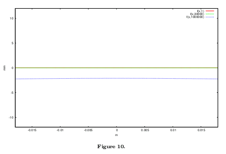

And halas, gnuplot draw:
Obviously wrong.
If the math are fine, I'll post my gnuplot script.
Buf first, did I made an error above?

It's hard to tell, but the view in Figure 10 above seems to be really tiny, like looking at the horizon thru a keyhole.
In such a small viewport, I wouldn't expect to see much curvature on the horizon.
Perhaps I've not understood the set-up. Let O be the centre of the Earth and P the pinhole. The projection of the Earth through the pinhole forms a cone with axis the continuation of OP. The image plane intersects this in a conic, the type of which depends on the angle between the plane and the axis (in relation to the angle of the cone).
If the camera is a rectangular box, with P opposite to the centre of the image area, A, I do not see how this can produce a hyperbola. That would require O and A to be on the same side of the panel where P is located. I.e., the Earth is inside the camera. The only result I can imagine is an ellipse.

It's hard to tell, but the view in Figure 10 above seems to be really tiny, like looking at the horizon thru a keyhole."
Numerical application used $$\epsilon=50mm$$ and viewport $$24 \times 36mm$$ which are pretty standard camera setting (default for any so called "full-frame" DSLD).
That's what I want to simulate.
NB: both axis should be in mm, would be nicer, but I didnt yet fixed that detail in gnuplot, so x-axis is still in m.

Hi,
Thanks everyone. I finally found my error. Now my result is compatible with Povray rendering of a similar scene and looks comparable to some ISS picts showing Earth shape from orbit.
Thanks again.
PS:
Error is stupid: y=-h in the circle equation, not y=+h...

So with your notations the horizon points that are to be projected are
##H = \{ M(x,y,z),\ \vec{PM}.\vec{OM} = 0,\ ||\vec{OM}||^2 = r^2,\ z\ge \epsilon \} = \{ M(x,y,z),\ y = \frac{r^2}{ r+h }, z \ge \epsilon, x^2 + z^2 = r^2 (1 - \frac{1}{r+h}) \}##
EDIT: ##H## is a portion of a circle centered in ##(0,\frac{r^2}{ r+h },0)## with radius ##r \sqrt{ 1 - \frac{1}{r+h}}##
Do we agree ?
Then what is the definition of a central projection ? For exemple, if it was an orthoprojection we would have ##\pi (M) = F_0 + \vec{\pi_{ {Oz}, \vec F}}(\vec {F_0 M }) = F_0 + \begin{pmatrix} 1 & 0 & 0 \\ 0 & 1 & 0 \\ 0 & 0 & 0 \end{pmatrix} \vec{F_0 M} ##
