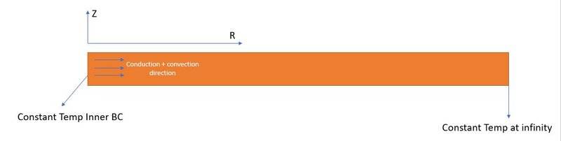

I want to simulate a 2D heat transfer process in the subsurface on a region which is infinite on the r-direction. So, as you know, the very basic way to model this is to draw a geometry that is very long in the r direction. I have done this, and the results that I obtain is correct as in this case, the results are matched with the analytical solution. As you know, there is a capability in Comsol called infinite element domain which serves the purpose to the problem mentioned above. In this case, we need to define a limited geometry on which we want to solve the PDE, and also need to draw a small domain acting as the Infinite Element Domain. However, in this case, the results are not correct because they are not matched with the analytical solution. Is there anything that I am missing to correctly use Infinite Element Domain in Comsol?

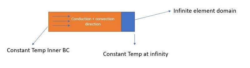

Please consider this geometry
At the inner BC, a fluid at constant temp is injected, and far at the infinity, the boundary condition is another constant temperature (lower than that at the inner BC). Also, the temp at initial condition is the same as that at the outer boundary condition. Now, the general way to model this is to draw this geometry whose length in the r direction is large. The simulation results are correct until the temperature at the outer boundary condition starts to increase. The problem has an analytical solution, based on which I have verified the numerical results.

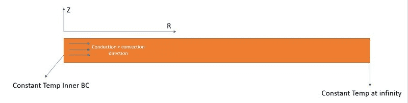

Another way to model this, is to use infinite element domain in Comsol. For this, the above geometry can be replaced with:
In this case, I assume even if temp at the outer boundary (at the bounded region, not at the infinite element domain) starts to increase, the results should be correct. However, the results in this case, is incorrect (unverified against the analytical solution). I wonder what I am missing, or if I am doing something wrong in Comsol?

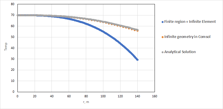

What are the differences in the results (analytical, finite element only model and the one with infinite elements) ?

Here are the results that I get:
Either I am missing something on how I should implement this Infinite Element in Comsol, or I am mistaken to believe that Infinite element works for this scenario.

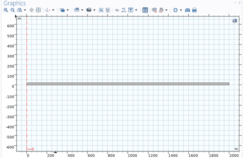

We want to obtain the temperature profile over the length of rw<r<140 m (rw is very small and is equal to 0.005 m here) at different times. One way to model this numerically in Comsol is to draw a rectangle that is 2000 m in the r-direction, and get results only in the span of r [rw,140] m:

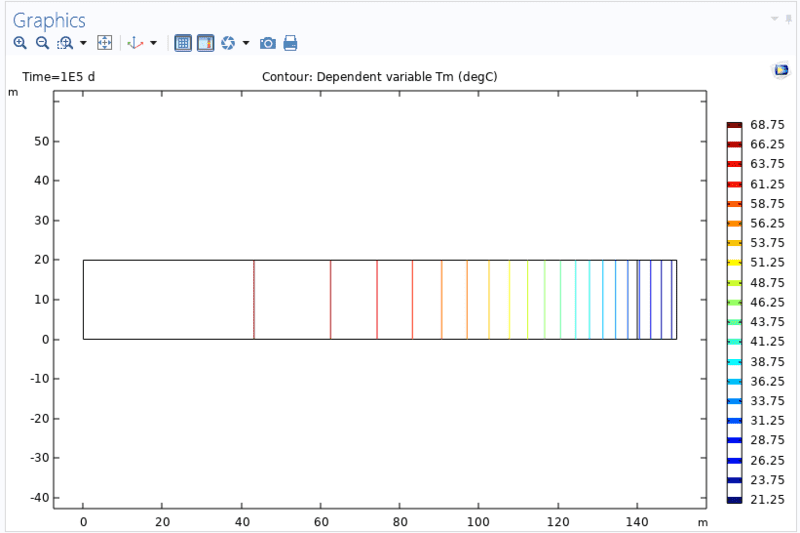

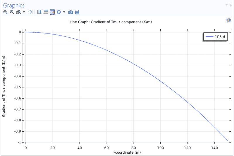

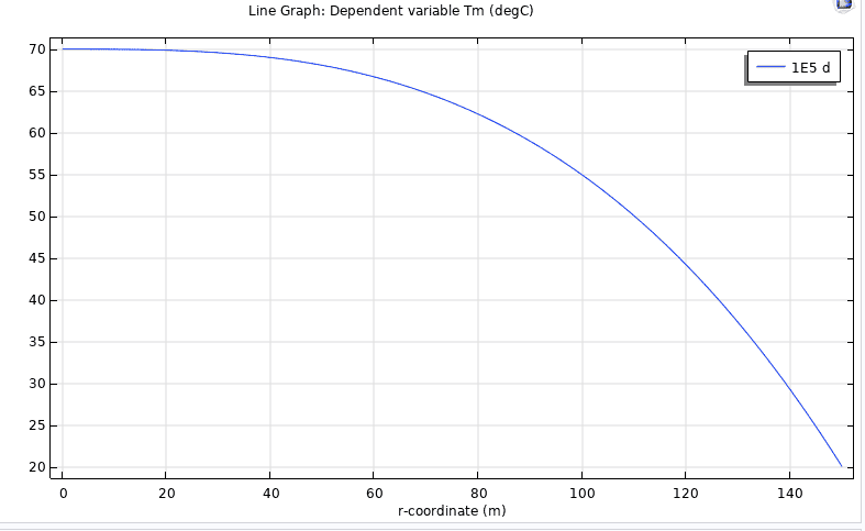

Do the temperature and heat flux contour plots look correct in the case when infinite elements are used ? Are their distributions continuous at the interface of these two domains ?
The temperature profile:
The temperature gradient (representing heat flux) profile:
The bounded region or the so-called ROI is 0.005<r<140 m and physical width of infinite element in the r-direction is 10 m. As you can see, the temperature and its gradient are both continuous at the interface (r=140 m).
As far as temperature and flux contours in both the bounded region and infinite element are concerned, I don't see anything suspicious. Here, for example, the contour map of temperature is:
