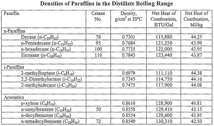

You can potentially take one source of hydrocarbons (like crude oil), pick the most energy dense hydrocarbon, and convert it all into that. Common types of hydrocarbons are the paraffins (like methane, ethane, octane, etc.) and aromatics. This is a table showing just a few of them:
You can see that these hydrocarbons ranges from 111,110 BTU/gallon to 130,310 (there are many more options). So you can definitely affect density by how you combine the hydrogen and carbon atoms. I don't know what the most energy-dense form is, but you could find out from a CRC Handbook.
Whether the conversion is worth doing depends on the efficiency of the process (how much energy is consumed by doing it, for example), and the reason for making it energy-dense (compactness on a space mission would be a good reason, where cost is no object).
