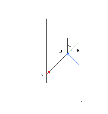

I am having a few doubts while writing relationship between angular speed and linear speed ,in the reference frame of a moving observer .
Suppose at an instant, car A is heading towards car B with velocity 'v'. Car B is moving towards right with velocity 'u' ,i.e along positive x-axis . The instantaneous distance between A and B is 's' .
What is the relationship between the different parameters at this instant ?
In the reference frame of car A ,the car B is rotating with angular velocity ω ,and translating with velocity ucosθ-v .
So , uT = sω where uT=usinθ is the tangential speed of car B .
Now,my confusion is angular speed is the time rate of change of angle .But which angle ? Is it θ or α or something else?
If it is θ then $$ s\dotθ = -usinθ $$ . If it is α ,then $$ s\dotα = usinθ $$ .
While dealing with angular speeds,I have difficulty in determining the angle ,whose time rate of change is ω.
I am not sure if what I have written makes sense .
I would be grateful if somebody could reflect his/her thoughts on this .

"Which angle" is really up to you, in two ways. First, the location of the "zero" angle is completely arbitrary, it can be the x-axis as depicted, the y-axis, or any other position. Second, you need to choose the "positive" direction. The choice is usually made so that the direction of the angular velocity vector will complete a right-handed triad with the x and y-axes. See http://en.wikipedia.org/wiki/Right-hand_rule . In 2D motion, this simply means that the positive direction is counter-clockwise.

Hi Voko...
Does that mean I can arbitrarily choose any line in the X-Y plane and consider angle between that line and AB ( say,β ) .Now $$ u_T =s\dot \beta $$ or $$ u_T = - s\dotβ $$ ,depending on whether I choose positive to be clockwise or anticlockwise .
Is it correct ?
Yes, that is correct.

It's not clear how you are defining alpha and theta. If they are defined by the relative positions of A and B, as in the diagram, at any time t, then both your equations are valid. ##\dot \alpha = -\dot \theta##.
Alpha is the angle which line joining A to B makes with Y-axis .Theta is the angle with the X-axis .

I meant that, instantaneously, the fact that A is moving has no affect on alpha, because the direction of A's movement happens to be towards B.
Yes, but that could be just the instantaneous condition. Since we are concerned with changes in alpha it's important to be clear that that definition applies at all times, even as A and B move. For example, it could have been that A is on a constant heading and only happens to be heading towards B at that instant. In that case alpha could be defined as that constant heading, and by definition its rate of change would have been zero.

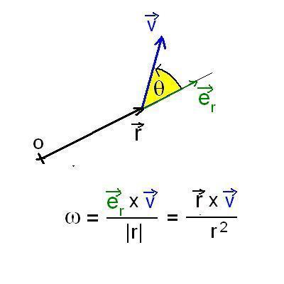

Chest is right, the best to do it with vectors.
The angular velocity of a point mass with respect to point O is
[tex]\vec \omega = \frac {\vec r \times \vec v }{r^2}[/tex].
##\vec r## is the position vector, ##\vec v## is the velocity. θ is the angle of ##\vec v## with respect to the direction of ##\vec r##. See picture.
If you determine the position vector and the relative velocity of B with respect to A you get the angular velocity of B with respect to A or vice versa from the cross product.
