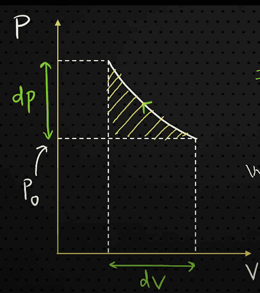

I was trying to solve a JEE ADVANCED 2020 paper 1 question 13 on thermodynamics. I attempted the problem and got a different answer than they did. I did it in a different way, but I can't find a mistake in both methods. So now I am stuck. I think the problem is in the first step probably using the direct formula but I can't pinpoint it.I also get their method which is more simple basically look at the area under the graph, and you see that whay you need to find is half of (dP)(dP) if you approximate it to a triangel. But I don't understand where I went wrong with mine. I used work done in adibatic conditions.

Here is how Sanjeew Sir does it to whom "respect" might be due. The spoken language sounds like a melange of about 20% English and 80% something else but the math is transparent. First he defines parameter ##x## which is the amount of radial compression from the initial radius, then finds an approximate expression for ##pdV## when ##x<<R## and finally does the integral. I think that one should save approximations until the very end of other mathematical manipulations such as integrals.

That's certainly the safer way, but in the present case I would argue that:
  1. ignoring the resulting increase in pressure, we get ##4\pi R^2ap_0## trivially
  2. the extra work from the increase in pressure must be a higher order term
Likes MatinSAR, vela and Chestermiller
I have questions about this. Does the integral suggested by @Chestermiller in post #4, $$W=4\pi p_0\int_R^{R-a}\left(\frac{R}{r}\right)^{3\gamma}(r^2)dr$$not give the exact expression for the work? If it does, the leading term in the series expansion of ##W## when ##\frac{R-a}{R}<<1## is the trivial expression ##4\pi R^2ap_0##. Are you saying that one should go beyond the leading term, which is linear in ##a##, and add to it a quadratic term in ##a##? There is nothing in the statement of the problem suggesting that and the conventional interpretation of ##a<<R## is "keep the leading term only."

No. The form of the question makes it clear that only the leading term is wanted. In post #8 I am saying we can find that leading term very easily.
It would have been clearer if I had ended the second bullet with "… so can be ignored".
