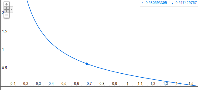

A uniform beam of length L and mass m is inclined at an angle θ to the horizontal. Its upper end
is connected to a wall by a rope, and its lower end rests on a rough, horizontal
surface. The coefficient of static friction between the beam and surface is μs.
Assume that the angle θ is such that the friction force is at its maximum value.
a) Draw a force diagram for the beam.
b) Using the condition of rotational equilibrium, find an expression for the tension T in the rope in terms of m, g and θ.
c) obtain an expression for μs, involving only the angle θ.
e) What happens if the ladder is lifted upward and its base is placed back on the ground slightly to the left of its former position? Explain.
I did a, b, and c, but I'm not sure on e. The graph shows μ in terms of the angle θ.
For e i wrote, so far, that FN would decrease because FT would now have a component in the same direction as FN.
If I'm understanding this right, μs is changing to maintain the equilibrium?
Also, I'm not sure what is meant by "Assume that the angle θ is such that the friction force is at its maximum value.".
True, but note the word "slightly". If you go through the algebra you will find that for a small displacement x the change in FT is of the order x2, so I think you are supposed to ignore that.
As θ changes, the necessary frictional force changes. They are saying that the position of the ladder is at the extreme angle for the given frictional coefficient. Any further (which way?) and the ladder would slip.

Does it depend on the length of the ladder? Because i found something, but I'm not sure if it's right.
It's a qualitative question. No, the length of the ladder does not matter.
If the base is shifted to the left, what will happen to the frictional force that is needed to maintain equilibrium? Will it increase, decrease or stay the same?
There will be need for an increased frictional force to stay up. If the frictional force doesn't increase it will fall over, i guess.
I tried to find out if the rate of change of μ that we found earlier was enough to maintain equilibrium while moving the base back. I guess that's not what was asked.
Yes, but it is a bit inaccurate to say it will fall over. The base might hit the wall first. Just say the ladder will slip, and give your reason.
Alright :D i didn't think of it hitting the wall, hehe.
Thanks lad!
