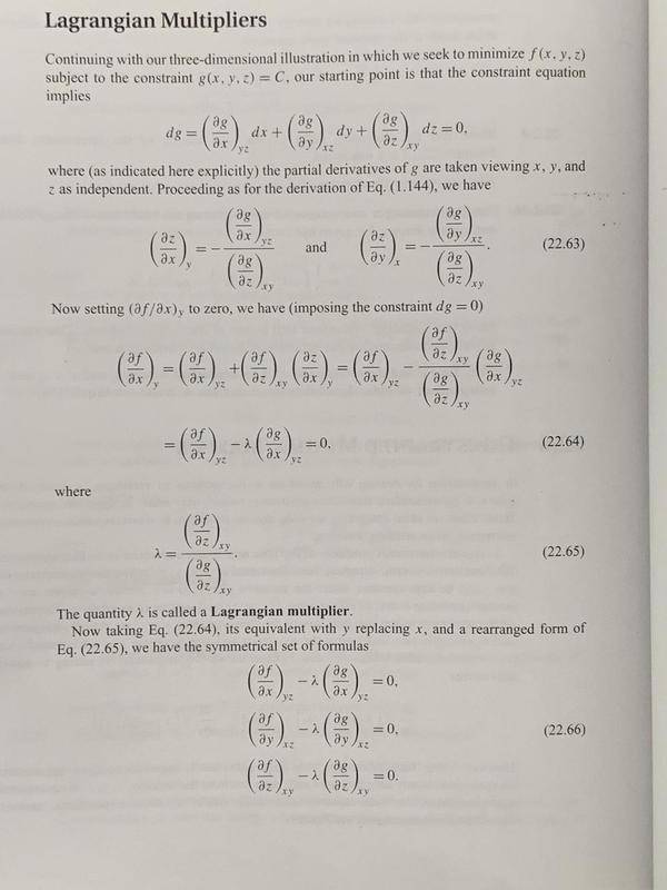

Given ##f(x,y,z) = f(x,y,z(x,y))## then what are the conditions involving the partial derivatives of $f$
Apparently they are
##\left(\frac{\partial f}{\partial x} \right)_y =\left(\frac{\partial f}{\partial y} \right)_x = \left(\frac{\partial f}{\partial z} \right)_z = 0##
where the subscript denotes the independent variable being held constant
As far as I know when a function is extremized its partial derivatives are all equal to 0 (provided we aren't dealing with a constraint)
##\left(\frac{\partial f}{\partial x} \right)_{yz} = \left(\frac{\partial f}{\partial y}\right)_{xz} = \left(\frac{\partial f}{\partial z}\right)_{xy} =0##
Let's start off
##\left(\frac{\partial f}{\partial x} \right)_{y} = \left(\frac{\partial f}{\partial x}\right)_{yz} + \left( \frac{\partial f}{\partial z} \right)_{xy} \left( \frac{\partial z}{\partial x} \right)_{y}##
I really don't know where to go from here. I'm not even sure my understanding of implicit functions is up to par to even begin addressing this question.

I understand everything up until the line right after (22.63)
Why are Arken and Weber setting
##\left( \frac{\partial f}{\partial x}\right)_y = 0## instead of ##\left(\frac{\partial f}{\partial x} \right)_{yz} = \left(\frac{\partial f}{\partial y}\right)_{xz} = \left(\frac{\partial f}{\partial z}\right)_{xy} =0##?
And presumably the other 2 equations in (22.66) come from setting
##\left( \frac{\partial f}{\partial y}\right)_z = 0##
##\left( \frac{\partial f}{\partial z}\right)_ x= 0##
after cyclically permuting. (It says the second equation comes from swapping x and y but I don't see it, also that doesn't explain the third equation)
Why these specific derivatives?

I know how to use the Lagrangian multiplier method. I'm trying to prove it.
Why is the first coordinate ##\left(\frac{\partial f}{\partial x}\right)_y##? Why is the second coordinate ##\left(\frac{\partial f}{\partial y}\right)_z##? Why is the third coordinate ##\left(\frac{\partial f}{\partial z}\right)_x##? I understand the chain rule helps us confirm these expressions.
I want to know why we set them = 0? I know that once we do we get the system of equations ##\nabla f = \lambda \nabla g##.

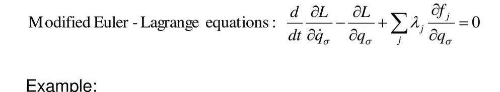

The reason I want to prove it in the manner shown above is because I eventually want to use the same approach for calculus of variations when a functional that depends on coordinates has constraints on coordinates.
Where ## \lambda_j ## is a function of t instead of a mere scalar factor. And in the calculus of variation case there is no clear geometric meaning. Furthermore the derivative definitions are more complicated.
Edit the constraints are of the form ##g_j(q_i(t)) = C##
I believe it's because the constraint removes one degree of freedom. You have the freedom to hold ##y## constant, but once you impose that condition, a change in ##x## generally requires a change in ##z## to remain on the surface ##g(x,y,z)=C##.
Likes PhDeezNutz
Let me see if I understand
##\left( \frac{\partial f}{\partial x} \right)_y = 0## z is a function of x and y so only x and y are allowed to vary, x is varying so y is constant.
##\left(\frac{\partial f}{\partial y} \right)_x = 0## z is a function of x and y so only x and y are allowed to vary, y is varying so x is constant.
I don't see how ##\left(\frac{\partial f}{\partial z}\right)_x = 0## is consistent with these choices. And therefore I don't see how we get the third equation in 22.64.
Either way, your post definitely helped. Even If I don't totally understand it.
