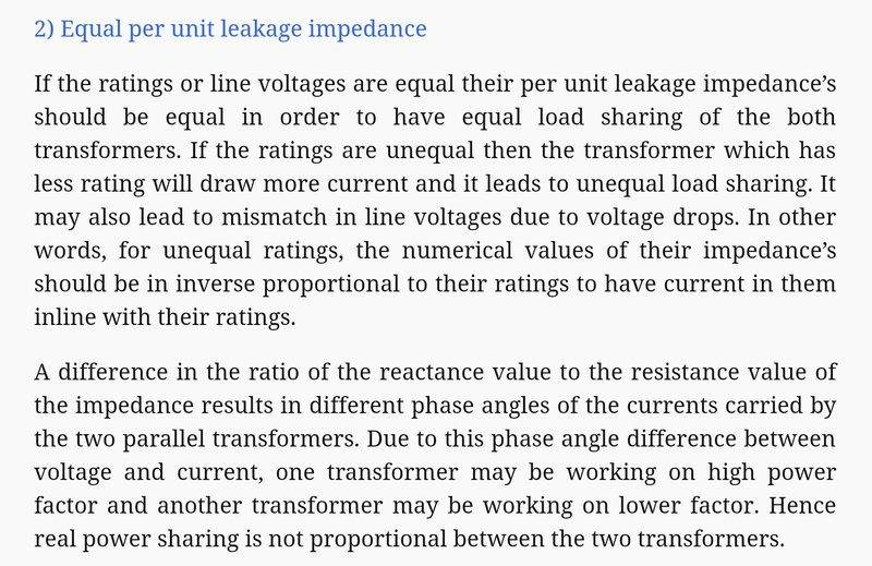

Can you find a reference anywhere that says winding resistance can be considered to be the real component of something called "leakage impedance"? It would be convenient if it were so, and power engineering is noted for stretching approximations out of convenience, though I'm uneasy about renaming winding resistance as "leakage resistance". The following implies it to be so, but I'd like to have it spelled out. http://ecetutorials.com/transformer/conditions-for-parallel-operation-of-transformers/
Your option (C) uses the word "reactance" whereas the Test Book Gate Question is consistent in using "impedance" in all 3 candidate options.
Option (C) would be approximately true providing that Xs » Rs, and I think for most power transformers this might be true. Can you check on that?

Yes, (3). Can you explain why (2) is not also correct?

(2) is not a requirement, this is explained in the final paragraph of the image I attached in post #4.

I didn't understand. In post 4, last point, it says that phase angle must be same. So why is this not a requirement? If X/R for both transformers in parallel are different there'd be circulating current which will cause heating of winding and then temperature will rise and boom :D
No, it says it's okay for the phase angles to differ. So long as the magnitudes of their P.U. impedances are equal then parallelled transformers will correctly share the current in proportion to their kVA ratings. But it points out that if you do the maths, you'll see they won't be sharing the load's watts in that same proportion.
So long as the transformer's VA rating is not exceeded, they don't go Boom. Circulating current is the price you pay for improvising with two non-ideal transformers in parallel to save having to buy a new big one.
