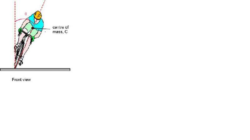

Consider a cyclist turning around a circular track with radius r and speed v as shown
in attached fig.
Let W be the weight of the system (cyclist + bicycle) (W = mg)
N = normal force by ground on the system
f = static friction by ground on the system
θ = angle of inclination between cyclist and the vertical
h = height of the centre of mass C of the system above the ground
d = perpendicular distance from the point of contact between the ground and
the tyres to the line of application of the weight
Horizontally:
f = m v2 / r
Vertically , for equilibrium:
N = mg
for rotational equlibrium, taking moment about the centre of mass (C), we get:
N d = f h
My question is : For rotational equilibrium, can't we take moment about the point of contact of cycle with track? As far as I know, for rotational equilibrium, moments can be taken about any point and their summation must be zero.
However, in this case, moment about the point of contact can't be zero as W produces a torque while torques due to N and f are zero. So the condition of rotational equilibrium gives two different conditions for two different points. Where is the fallacy?
Moment about the bottom most point :
moment = W x d
The problem with finding moments about the point of contact is that such a point is accelerating. The CM has the special property that the torque about it equals the rate of change of angular momentum in all cases. Not so for accelerating points in general.
There is no fallacy. As Doc Al pointed out, the system is accelerating.
In an accelerating system the moments about a point other than cm are not 0(zero), but M(effective).
You can find M(eff) by integration. Take an element of mass dm and find its force(s). Sum all elemental masses dm to find the M(eff) and F(eff) . In this way you can takes the moments about any point. Nonetheless, such an approach can involve complicated calculations, depending upon the shape of the body. You may want to look up d'Alembert's principle.
Note that when we use the cm to do calculations, the result is an approximation, for anybody not symmentrical about the axis of rotation. The reason being is that the radius r of rotation changes for each element of the body. The effective force will not reduce to a vector attached to the cm rotating about the axis. In most cases the difference is small and we use the cm as the location for the effective force to simplify the calculations.
As an example, consider an airplane making a banking turn. The airplane has an axis of symmetry: two elements of mass equally distant from the centre of the airplane will produce an effective force not equal to each other.
For the higher up wing : F1 = dm r1 omega^2
For the lower wing : F2 = dm r2 omega^2
where r1 > r2
Solving for the effective forces will produce a force and couple at cm of the plane, which can be replaced by an effective force off-centre from the cm.
