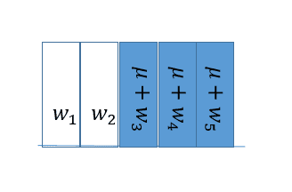

the following modulation is in the frequency domain, x-axis is frequency , y-axis is amplitude of electric current.
the signal is a pulse divided to 5 equally slots by means of electrical current where 2 "holes" indicating the binary message.
for this example my constellation size is 2^3. therefore 5C2 = 10 combinations is possible in this setup (5 slots and 2 "holes") and i'll will use 8 of them.
i am trying to calculate probability as described :
w1,w2,w3,w4,w5 are normally distributed i.i.d R.V (AWGN).
A correct detection is when the noise in slots 1 and 2 both is smaller than the noise + mu(the current related to the slot).
w_1,w_2<min(\mu+w_3,\mu+w_4,\mu+w_5)
so the probability for correct detection as I'm thinking is:
1. P_{correct}= P(w_1<\mu+w_3\cap w_1<\mu+w_4\cap w_1<\mu+w_5\cap w_2<\mu+w_3\cap w_2<\mu+w_4\cap w_2<\mu+w_5)
if I'm right, i can calculate just one of the terms , because of the i.i.d properties.
2. P_{correct}= P(w_1<\mu+w_3)P(w_1<\mu+w_4)P(w_1<\mu+w_5)P(w_2<\mu+w_3)P(w_2<\mu+w_4)P( w_2<\mu+w_5)
P_{correct}= P(w_1<\mu+w_3)^6
where
P(w_1<\mu+w_3)= \int_{-\infty}^{\infty}\frac{1}{\sqrt{2\pi}\sigma}e^{-\frac{w_1^2}{2\sigma^2}}Q(\frac{w_1-\mu}{\sigma})dw_1
hence the error probability is :
P_{error}=1-P_{correct}
therefore the general case with n- slots and k- "holes" the probability is
3.P_{correct}=\left[\int_{-\infty}^{\infty}\frac{1}{\sqrt{2\pi}\sigma}e^{-\frac{x^2}{2\sigma^2}}Q(\frac{x-\mu}{\sigma})dx\right]^{(n-k)k}
i did another calculation with my friend and we got:
4.P_{correct}=\left[\int_{-\infty}^{\infty}\frac{1}{\sqrt{2\pi}\sigma}e^{-\frac{x^2}{2\sigma^2}}\left[Q(\frac{x-\mu}{\sigma})\right]^{(n-k)}dx\right]^k
i'm trying to understand which of Eq.3 or Eq.4 is the correct answer ? and the transition from Eq.1 to Eq.2 is legal, meaning, are slots 1,2,3,4,5 are absolutely independent ?
A way to put that in familiar territory is:
[itex]max(w_1,w_2) < min(\mu+w_2,\mu+w_4,\mu+w_5) [/itex]
Look at the theory of "order statistics" to find out how the max and min are distributed.
