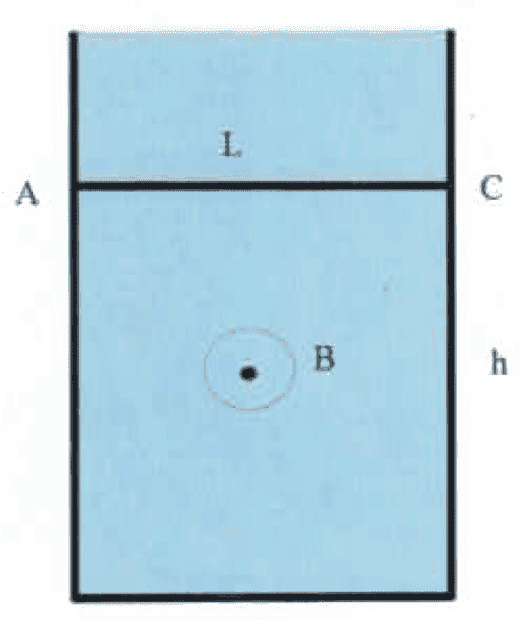

A conducting rod ##AC## of mass ##m=0.1\ kg##, length ##L=1\ m## and resistance ##R=5\ \Omega## can move without friction on two metallic rails in a region where there is a uniform magnetic field, perpendicular to the plane of the circuit and with magnitude changing with time.
##B(t_0=0)=2\ T## and the rod is in equilibrium at height ##h=3\ m##.
(a) Determine the magnetic force, the current (in direction and magnitude) and the electromotive force induced at time ##t_0=0##.
(b) Verify that if ##B(t)=B_0\sqrt{1-At}## the magnetic force is constant and find the value of ##A## such that the rod remains still.
(c) In these conditions, find the total charge that has gone around the circuit in the time interval from ##t_0=0\ s## to ##t_1=10\ s##.
(d) Find out for how much time the rod remains in equilibrium.

I am having problems understanding point (b) so I would like to know if my reasoning in that part is correct and/or how to think about that part because I don't see how to justify the assumption ##v_y=0\ m/s##. Thanks.
I set up the ##xyz## coordinates system in the usual way with ##xy## in the plane and ##z## pointing upwards.
(a) The current at time ##0##, ##i(0)## should go around in a counterclockwise fashion otherwise it would help the weight pull the rod down and also ##i(0)LB(0)=mg\Rightarrow i(0)=\frac{mg}{LB(0)}## (1).
Also, by Ohm's Law we have that the electromotive force is ##\mathcal{E(0)}=i(0)R\overset{(1)}{=}\frac{mg}{LB(0)}##.
(b)
##i(t)=\frac{\mathcal{E(t)}}{R}=\frac{1}{R}(-\frac{d\phi(\vec{B})}{dt})=-\frac{1}{R}(\frac{d}{dt}\int_{S}\vec{B}\cdot d\vec{S})=-\frac{1}{R}(\frac{d}{dt}\int_{S}B_0\sqrt{1-At}dS)=-\frac{B_0}{R}(\frac{d}{dt}\sqrt{1-At}\int_S dS)=-\frac{B_0}{R}(\frac{d}{dt}\sqrt{1-At}\int_{0}^{y} L d\bar{y})=-\frac{LB_0}{R}(\frac{d}{dt}\sqrt{1-At} y)=-\frac{LB_0}{R}\left( -\frac{A}{2\sqrt{1-At}}\cdot y+\sqrt{1-At}\cdot v_y \right)##
so
##F_m(t)=i(t)LB(t)=-\frac{LB_0}{R}\left( -\frac{A}{2\sqrt{1-At}}\cdot y+\sqrt{1-At}\cdot v_y \right)\cdot L\cdot B_0\sqrt{1-At}=-\frac{L^2B_0^2}{R}\left( -\frac{A}{2}y+(1-At)v_y \right)##
so it seems to me that the only way that the magnetic force could be constant is if ##v_y=0## but can I assume this?
In that case ##F_m=\frac{L^2B_0^2 A}{2R}y## and to balance the weight it should be ##F_m-mg=0\Leftrightarrow \frac{L^2B_0^2 A}{2R}y=mg\Leftrightarrow A=\frac{2Rmg}{yL^2B_0^2}## but I am not sure which ##y## I should pick.

I don't think you have been careful enough with part (a). If the at t = 0 the rod is in equilibrium, that means it is not moving. You have the weight ##mg## down and the magnetic force ##F_M## up and the two must be equal. Consider that $$\frac{d\Phi}{dt}=\frac{d}{dt}(BA)=B\frac{dA}{dt}+A\frac{dB}{dt}.$$This allows you to find the time derivative of the magnetic field at ##t_0##. I would write a differential equation for Newton's second law.

I don't completely get what you are suggesting but I tried and got: ##iR=-\frac{d\Phi}{dt}=BL\frac{dy}{dt}+Ly\frac{dB}{dt}=Ly\frac{dB}{dt}## and substituting in Newton's second law I would get: $$iLB-mg=0\Rightarrow -\frac{L^2yB}{R}\frac{dB}{dt}-mg=0\Rightarrow \frac{L^2 hB}{R}\frac{dB(0)}{dt}=-mg\Rightarrow \frac{dB(0)}{dt}=-\frac{mgR}{L^2hB(0)}$$ but I don't see how knowing ##\frac{dB(0)}{dt}## helps me (and also what is wrong with the way I found ##i(0)## out originally)
First, in part (a) you are asked to find the magnetic force. That means an expression for the magnetic force in terms of the variables. To do this correctly, you need to find a general expression and then see what happens at ##t_0=0##. You have at any time a current magnitude $$i(t)=\frac{1}{R}\left(B\frac{dA}{dt}+A\frac{dB}{dt}\right)=\frac{1}{R}\left(BL\frac{dy}{dt}+Ly\frac{dB}{dt}\right).$$At time ##t_0=0## you need to be careful with the derivatives.
$$i(0)=\frac{1}{R}\left(B(0)L\left. \frac{dy}{dt}\right |_{t=0}+Ly(0)\left.\frac{dB}{dt}\right|_{t=0}\right).$$You multiply that by ##LB(0)## to get the magnitude of the magnetic force.

For part (b), perhaps I need to double-check my calculation, but I don't know that I agree with their claim that the magnetic force is constant, i.e. independent of time for the given ## B(t) ##. I have an expression for the force that contains ## y(t) ## and ## v_y(t) ##. If the force is constant, then ## y(t)=y_o+\frac{at^2}{2} ##, and ## v_y(t)=at ##. When these are substituted back into the expression for the force, it seems there is a time dependence. Perhaps I made an error somewhere...
Edit: Reading the problem more carefully, I see they give initial conditions that essentially mean that ## a=0 ##, and with that part included, yes the magnetic force is constant...
Likes Delta2
Yes, the force is constant.
Likes Delta2 and Charles Link

I get the same result I got in my initial answer: ##i(0)=-\frac{Lh}{R}\frac{dB(0)}{dt}##, ##i(0)LB(0)-mg=0\Rightarrow -\frac{L^2 hB(0)}{R}\frac{dB(0)}{dt}=mg\Rightarrow \frac{dB(0)}{dt}=-\frac{mgR}{L^2 hB(0)}## so ##i(0)=\frac{mg}{LB(0)}##
The problem is that with my ##A=\frac{2Rmg}{hL^2B_0^2}## I get a current ##i(t)=-\frac{1}{R}\frac{d\phi(\vec{B})}{dt}=-\frac{1}{R}\frac{d}{dt}\int_{S}B_0\sqrt{1-\frac{2Rmg}{hL^2B_0^2}t}dS=-\frac{LhB_0}{R}\frac{d}{dt}\sqrt{1-\frac{2Rmg}{hL^2B_0^2}}=\frac{mg}{LB_0\sqrt{1-\frac{2Rmgt}{hL^2B_0^2}}}## and since ##\frac{2Rmgt}{hL^2B_0^2}=\frac{9.8}{12}## I cannot integrate ##i(t)## in part (c) on the whole interval from ##0##s to ##10##s to find ##i(t)## because the argument of the square root because negative from a certain point onward in that interval.

You need to be more careful with what you put down. You wrote
$$i(t)=-\frac{1}{R}\frac{d\phi(\vec{B})}{dt}=-\frac{1}{R}\frac{d}{dt}\int_{S}B_0\sqrt{1-\frac{2Rmg}{hL^2B_0^2}t}dt$$This is incorrect for two reasons: (a) the function ##i(t)## is not equal to its integral over time ##t## and (b) the integral is over time not over some surface ##S##.
Write the correct integral expression formally, with the correct variable on the left hand side and maybe you will see what to do next and finish part (c).
