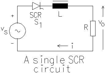

In summary, the term θ (conductive angle) in a half wave SCR rectifier with RL load represents the voltage/current phase angle caused by the inductor field collapsing. The SCR is fired at the firing angle (α) but continues to conduct until ∏ + θ due to the inductor field collapsing.
buildingblocs
Hi all,
When considering a half wave SCR rectifier (single phase) with an RL load, the term θ (conductive angle) appears in equations relating to the performance of the circuit.
In terms what is physically happening in the circuit, what does θ actually represent?
considering a single period to be 0 to 360 degrees, the scr turns on at the conduction angle.
I thought the SCR is turned on at the firing angle (α).
Below are the formulas that I am referring to:

OK, my bad. Firing angle is angle at which it starts conducting, conduction angle is angle over which it conducts.
But theta in the above circuit is the voltage/current phase angle caused by the RL circuit. The SCR is fired at α, but conducts beyond ∏ -α because of the inductor field collapsing, represented by theta. So it continues to conduct until ∏ + theta.
