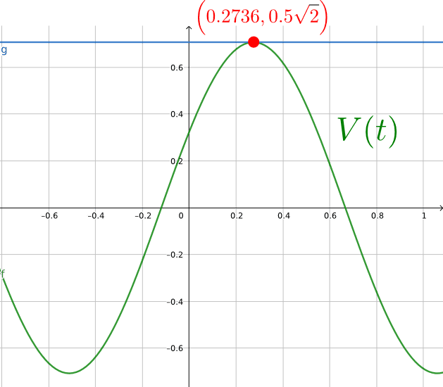

I need the parameter [itex]t[/itex] to correspond for when [itex]V[/itex] takes its peak value. But I just do not see the relation... I do not see how can I get rid of the [itex]t[/itex].
I have been playing with the graphs of the situation and I found that if I want [itex]V_{\text{peak}}[/itex] to be equals to [itex]\sqrt{2} V_{\text{RMS}} = 0.5 \sqrt{2}[/itex] I need the velocity [itex]v[/itex] to be approximately equals to 0.51625 and in consecuence [itex]t=0.2736[/itex]
The green curve is the curve that correspond to the voltage [itex]V = vB (2 \pi r) - \frac{dB}{dt} (\pi r ^2)[/itex]. Desmos Link.
244375
But without the graph and the approximations I am lost with the equation
[tex]v = \frac{ 0.5 \sqrt{2} - 0.2 \pi \sin(4t)}{0.2 \pi \cos (4t)}[/tex]
I tought that maybe I could find [itex]t[/itex] by finding what value of [itex]t[/itex] verifies [itex]\frac{dV}{dt} = 0[/itex]. But for that I would need the value of velocity [itex]v[/itex]...

But then when you find the RMS values, I don't think you are doing that correctly.
Let me give you an example. If
[itex] V(t) = V_{peak} \cos (\omega t), [/itex]
then
[itex] V_{rms} = \frac{V_{peak}}{\sqrt{2}}. [/itex]
Note that the sinusoid goes away along with the t.
I mean that [itex] V_{rms} \neq \frac{V_{peak}}{\sqrt{2}} \cos (\omega t),[/itex] rather it's just [itex] \frac{V_{peak}}{\sqrt{2}} [/itex].
As soon you divide things by [itex] \sqrt{2} [/itex] to switch over to RMS, there shouldn't be any sines or cosines left.

$$v =\sqrt{\left( \frac{0.5 \sqrt{2}}{0.2 \pi} \right) ^2 - 1}$$
$$v =0.51625$$
And that is the value that I have found previously with the graphic, so I suppose it is correct. Right?
I really appreciate your help @collinsmark Thank you very much for your guidance.
@scottdave your question was really helpful to make me rethink the relation between the signal and its RMS value. Thank you very much.

I thought that I had understood it well, please let me explain in detail my procedure to solve the problem.
First I will answer the practice example 4 to be sure that I understand where RMS value of a signal comes from.
Let me see, I can derive it seeing the other examples.
[tex]x_{\text{peak}} = 0.2[/tex]
[tex]x_{\text{RMS}} = \frac{0.2}{\sqrt{2}}[/tex]
But I know how to analyze it.
By definition I think that RMS value of a signal is
[tex]x_{\text{RMS}} = \sqrt{ \frac{1}{T} \int _0 ^{T} x(t)^2 dx}[/tex]
The signal of practice example 4 have a period [itex]T = \frac{\pi}{2}[/itex]. I know that because the function [itex]\cos (x)[/itex] has a period [itex]T = 2 \pi[/itex] then if you multiply the argument of the function by 4 you are making it 4 times smaller.
[tex]x_{\text{RMS}} = \sqrt{ \frac{1}{\frac{\pi}{2}} \int _0 ^{\frac{\pi}{2}} (0.2 \cos (4t))^2 dx}[/tex]
[tex]x_{\text{RMS}} = 0.2 \sqrt{ \frac{1}{\frac{\pi}{2}} \int _0 ^{\frac{\pi}{2}} \cos^2 (4t) dx}[/tex]
[tex]x_{\text{RMS}} = 0.2 \sqrt{ \frac{1}{\frac{\pi}{2}} \int _0 ^{\frac{\pi}{2}} \frac{1+ \cos (2 \cdot 4x)}{2} dx}[/tex]
[tex]x_{\text{RMS}} = 0.2 \sqrt{ \frac{2}{\pi} \frac12 \int _0 ^{\frac{\pi}{2}} (1+ \cos (2 \cdot 4x)) dx}[/tex]
[tex]x_{\text{RMS}} = 0.2 \sqrt{ \frac{1}{\pi} \left( \int _0 ^{\frac{\pi}{2}} 1 dx + \int _0 ^{\frac{\pi}{2}} \cos (2 \cdot 4x) dx \right) }[/tex]
[tex]x_{\text{RMS}} = 0.2 \sqrt{ \frac{1}{\pi} \left( \frac{\pi}{2} + \frac18 \left( \sin \left( 8 \cdot \frac{\pi}{2} \right) - \sin \left( 8 \cdot 0 \right) \right) \right) }[/tex]
[tex]x_{\text{RMS}} = 0.2 \sqrt{ \frac{1}{\pi} \frac{\pi}{2} }[/tex]
So seeing these examples I thought that there is a pattern... If you have a signal with a sinusoidal form for example.
$$y(t) = A \sin(\omega t + b)$$
The peak and RMS values are:
[tex]x_{\text{peak}} = A[/tex]
[tex]x_{\text{RMS}} = \frac{A}{\sqrt{2}}[/tex]
Then in my problem I have a loop that is moving in a uniform magnetic field and it is varying its area. So I know that the induced voltage will be determined by
$$V = \int \left(\vec{v} \times \vec{B}\right) \bullet \vec{dl} - \oint _S \frac{\vec{dB}}{dt} \bullet \vec{ds}$$
From the statement it can be deduced which vectors are parallel with others and which vectors are perpendicular with others
$$V = \int vBdl - \oint _S \frac{dB}{dt} ds$$
The magnetic inductance is varying respect time but it is uniformly applied on the area so at certain moment [itex]t[/itex] it can be considered constant and can be separated from the integrand. The same happens with its derivative.
$$V = vB \int dl - \frac{dB}{dt} \oint _S ds$$
$$V = vB (2 \pi r) - \frac{dB}{dt} (\pi r ^2)$$
$$V = v(0.2 \cos (4t)) (2 \pi r) + 0.8 \sin (4t) (\pi r ^2)$$
Now I replace the value of [itex]r = 0.5[/itex]
$$V = 0.2 \pi v \cos (4t) + 0.2 \pi \sin (4t)$$
I have a sinusoidal signal V, and I thought it could be well if I can transform my signal so it could have the form
$$V(t) = A \sin(\omega t + B)$$
Then I do what I did in my last post
$$V = 0.2 \pi (v \cos (4t) + \sin (4t))$$
I say that "there is" a right triangle where one side length is [itex]v[/itex] and the other side length is [itex]1[/itex]. The angle between these sides is alpha. And the hypotenuse length is [itex]\sqrt{v^2 + 1}[/itex]
244396
Then I can replace V and 1.
$$v=\sqrt{v^2 + 1} \sin (\alpha) $$
$$1 = \sqrt{v^2+1} \cos (\alpha)$$
$$V = 0.2 \pi \left( \sqrt{v^2 + 1} \sin (\alpha) \cos (4t) + \sqrt{v^2+1} \cos (\alpha) \sin (4t) \right)$$
$$V = 0.2 \pi \sqrt{v^2 + 1} (\sin (\alpha) \cos (4t) + \cos (\alpha) \sin (4t))$$
Now I use a trigonometric identity that says [itex]\sin \alpha \cos \beta + \cos \alpha \sin \beta = \sin (\alpha + \beta) [/itex]
$$V = 0.2 \pi \sqrt{v^2 + 1} (\sin (4t + \alpha))$$
Now I have the signal V expressed in such way that allows me to see clearly that the peak value must be [itex]0.2 \pi \sqrt{v^2 + 1}[/itex]
Knowing that for a sinusoidal wave (including this case) the RMS value is
$$V_{\rm{rms}} = \frac{V_{\rm{peak}}}{\sqrt{2}} $$
$$V_{\rm{peak}} = V_{\rm{rms}} \sqrt{2} $$
The value of RMS voltage is given in the statement. I can replace the variables and find [itex]v[/itex].
$$0.2 \pi \sqrt{v^2 + 1}=0.5 \sqrt{2}$$
$$\sqrt{v^2 +1} = \frac{0.5 \sqrt{2}}{0.2 \pi}$$
$$v^2 +1=\left( \frac{0.5 \sqrt{2}}{0.2 \pi} \right) ^2$$
$$v = 0.51625 \left[ \frac{\text{m}}{\text{s}} \right]$$

Now I see what you did there. That looks correct* to me. :smile: Good job!
*(Well, "correct" in the sense that it may be the answer your coursework is looking for. But this problem is a little ill-conceived due to the use of RMS on a non-stationary signal.)
[ps., forgive me for not seeing this a couple of posts ago. You were correct there too.]
