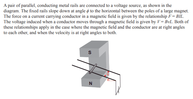

Conductor rolling down an inclined plane in a vertical B-field
In summary, the problem involves finding the value of theta in terms of phi using the magnetic force cross product formula. However, the given equation for this is incorrect and the direction of the magnetic force needs to be considered. It is unclear if the roller is sliding or rolling along the rails and this may affect the calculation. The problem statement also mentions a battery, but it is not clear if it is part of the circuit. There is a possibility of replacing the battery with a resistor R, which is included in the target expression. The case of constant velocity may also affect the solution, depending on if the roller is sliding or rolling.

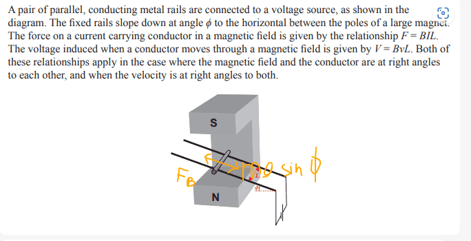

Please see below
Please see below

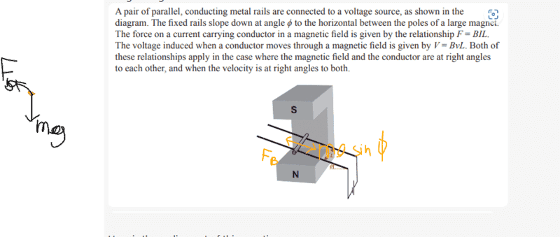

For part (c) of this problem,
My working is

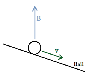

However, the tricky part is to find theta. I tried to draw the situation so that I could find theta:
It appears that theta = 90 degrees. However, this does not seem to be correct. Does anybody please know how to correctly find theta in terms of phi?
Please note I am trying to do it in using the magnetic force cross product formula while the solutions find the components of perpendicular to each other then use the magnetic force formula that is only valid when the magnetic field, current and velocity are at right angles.
Thank you!
The roller is horizontal and the field is vertical, as shown in your figure. So, the angle ##\theta## is 90 degrees, as you say.
However, your equation ##mg\sin\phi= ILB \sin \theta## is not correct. What is the direction of the magnetic force on the roller? Be sure to sketch a good free-body diagram for the roller.
The problem statement doesn't say if the roller slides or rolls along the rails. Maybe it was stated in an earlier part of the problem.
The problem statement says,
This is not always true and it's not true for this problem. Do you see why? For example, what would be the induced voltage if the rod is oriented horizontally but moving vertically downward parallel to the B field?
Edit: the problem statement addresses this when it says:
But you can see that in this problem the velocity is not at right angles to B.

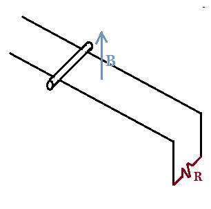

Is the electrical resistance of the roller given? [Edit: Nevermind, the resistance ##R## is included as part of the answer. Somehow I overlooked it.]
The figure given with the problem appears to show a battery in the rail circuit. But no mention of this is made in the problem statement.

Thank for your reply @TSny!
The direction of the magnetic force is up the incline at an angle phi. I got this from my free body diagram and using the right-hand rule:

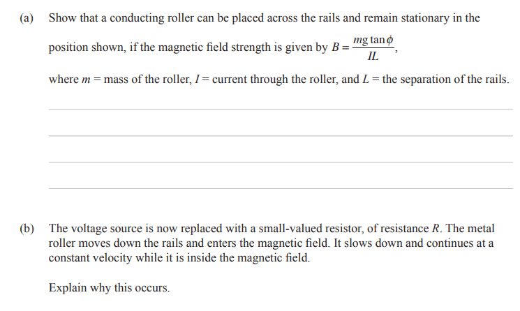

Here is the earlier part of this question:
Yeah, I see what mean about that V = BvL formula. I guess we will just have to find the components that are perpendicular.
Source: Q1 of https://www.nobraintoosmall.co.nz/NCEA/phySch/exams/Sch/Exams/93103-exm-2016.pdf
Does it work if we replace the battery with a resistor R? There is an R in the target expression.
I see now that according to part (c), ##R## is the resistance of a resistor that replaces the battery. So, it's OK.

The equation ##mg\sin\phi = ILB\sin\theta## is not correct.
Draw a free-body diagram for the roller showing all of the forces that act on the roller.
Could you please show me how to solve this problem using the cross-product definition of the magnetic force.
The right-hand rule for the cross-product comes into play in getting the direction of the magnetic force.

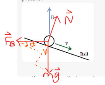

Here is the free body diagram,
Sorry it's a bit messy, so I'll put it into words. The magnetic force acts up at angle phi to the horizontal on the roller, while the weight of the roller acts vertically downwards. The normal force is perpendicular to the inclined rail (not shown in the diagram).
Many thanks!

If those are the only forces then the roller will accelerate into the rail.
Likes member 731016
Thank you @haruspex! Sorry I forgot to add the normal force which is perpendicular to the inclined rail.
Many thanks!

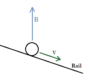

No. To get the right direction for the magnetic force on the moving roller, you first need to know which way the current flows in the roller. Here is a side view of the roller moving down the rail.
Which way is the induced current flowing in the roller: into the page or out of the page? What is the reason for your answer?

There is no battery for part (c) of the problem. The current in part (c) is induced by the magnetic field. One way to determine the direction of the induced current is to imagine a positive charge carrier inside the conducting roller. As the roller moves down the slope with velocity ##\vec v##, what would be the direction of the magnetic force on the charge carrier? Recall the Lorentz force law ##\vec F_B = q \vec v \times \vec B##. What is the direction of ##\vec v \times \vec B## in this picture?
Or, if you've studied Faraday's law of induction, you can get the direction of the induced current by considering Lenz's law. The roller is part of a circuit consisting of the roller, the two rails, and the resistor.
The magnetic field of the magnet produces a magnetic flux through the circuit. The flux changes as the roller moves. You can use Lenz's law to determine the direction of the induced current in the circuit.

Oh, right the Lorentz force Law! Thank you @TSny !
I guess the force it out of the screen, so the current is out of the screen too.
Many thanks!
Yes. So, if the current in the roller is out of the page, what is the direction of the magnetic force on the current? Here, you need to consider the direction of the cross product in the force law ##\vec F = I\vec L \times \vec B##, where ##\vec L## has the direction of the current in the roller.

Thanks for the reply @TSny! Up the incline. Thanks!
Callumnc1 said:
Up the incline.
No. You're not correctly using the right-hand rule for getting the direction of the cross product of two vectors. I'll let you work on this. I need some sleep :sleep:

I think I found my mistake when applying the right-hand rule. Here is my new free body diagram:
From here I think I just decompose the gravitational and magnetic force into the components parallel to the incline:
Many thanks!
Many thanks!
Looks good.
