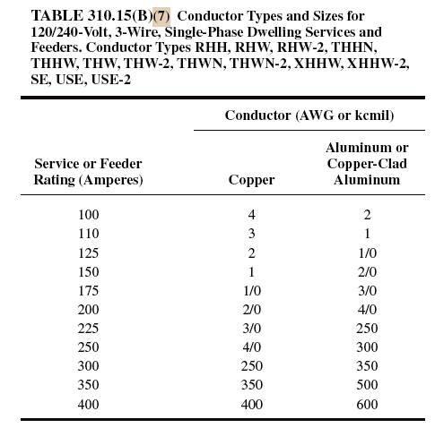

The allowance is not for how many conductors are in a conduit I could have 6 single phase conductors in one conduit and 6 three-phase conductors in another conduit, same wire and conduit characteristics but I can use a larger overcurrent device on the single phase circuits.
The allowance I am investigating is 310.15(B)(7) (2017 NFPA 70(NEC))
"(7) Single-Phase Dwelling Services and Feeders. For onefamily dwellings and the individual dwelling units of two-family and multifamily dwellings, service and feeder conductors supplied by a single-phase, 120/240-volt system shall be permitted to be sized in accordance with 310.15(B)(7)(1) through (4). For one-family dwellings and the individual dwelling units of two-family and multifamily dwellings, single-phase feeder conductors consisting of 2 ungrounded conductors and the neutral conductor from a 208Y/120 volt system shall be permitted to be sized in accordance with 310.15(B)(7)(1) through (3).
(1) For a service rated 100 through 400 amperes, the service conductors supplying the entire load associated with a one-family dwelling, or the service conductors supplying the entire load associated with an individual dwelling unit in a two-family or multifamily dwelling, shall be permitted to have an ampacity not less than 83 percent of the service rating.
(2) For a feeder rated 100 through 400 amperes, the feeder conductors supplying the entire load associated with a one-family dwelling, or the feeder conductors supplying the entire load associated with an individual dwelling unit in a two-family or multifamily dwelling, shall be permitted to have an ampacity not less than 83 percent of the feeder rating.
(3) In no case shall a feeder for an individual dwelling unit be required to have an ampacity greater than that specified in 310.15(B)(7)(1) or (2).
(4) Grounded conductors shall be permitted to be sized smaller than the ungrounded conductors, if the requirements of 220.61 and 230.42 for service conductors or the requirements of 215.2 and 220.61 for feeder conductors are met."The requirement you are thinking of is 310.15(B)(3)(a) (More than three current-carrying conductors)

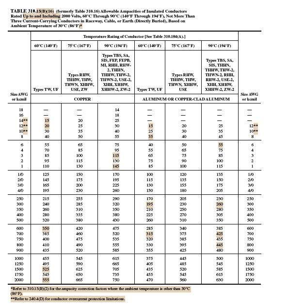

Yep, thanks. I don't expect the conductors insulation to degrade or for the conductor to be operating precisely on the table temperature at the specific current in the table, I would expect some safety factor in there.
But a huge concern of mine if you are interested, is time current curves of over-current protection devices and them being based on 40 degrees C ambient. For example, say we have a 175 amp thermal magnetic circuit breaker, say a standard Square D QO, see the trip curve in the link below.
http://download.schneider-electric.c...ame=736-06.pdf
QOM FAMILY MOLDED CASE CIRCUIT BREAKERS CHARACTERISTIC TRIP CURVE NO. 736-6
175A breaker at 180 amps will take 16 minutes to 2.7 hours to trip at 40*c ambient temp cold start
218 amps(175 x 1.25) is 5.8 minutes to 2.7 hoursNow, let's say this main breaker is in an outdoor meter and main combination enclosure for a house in say Minnesota. Now say it is the dead of winter, the main feeder runs quite a way in the house inside insulation. And say for whatever reason they use a lot of electric heat and other electric loads.Below is the table that was used in this code section prior to 2014 and is returning in 2020, I included it so you don't have to do the 83% calculation required in 2017.
One of the common interpretations that I have heard from actually well respected NEC aficionados is that you are allowed to use 310.15(B)(7) and have a calculated load for the house which is above the 310.15(B)(16) table ampacity for the conductor, and that is not by using a lower ambient temperature or anything, that is just in general, you are allowed to do that. I don't believe that interpretation if you hadn't guessed that already, but the other interpretations pose similar problems. If the breaker is in a low enough ambient temperature, the circuit conductors could run well above 310.15(B)(16) ampacity indefinitely, the breaker operating properly and as expected(by anyone that knows the trip curve and 40 degree C rating) would never trip until the circuit conductors melt and then it would hopefully trip on short circuit current(magnetic trip element) before they ignite the structure.
But service conductors on the line side of the breaker are only protected by overcurrent protection downstream of the conductors, they would likely burn the structure to the ground before the utility cutout fuse would open, albeit these will likely not be buried in hot insulation. But it can go the other way as well, overcurrent device in air conditioned space with the service conductors outdoors in the Arizona summer operating above their 310.15(B)(16) ampacity indefinitely.Just a related side note, the table was removed for 2014 because of misapplication in the industry.

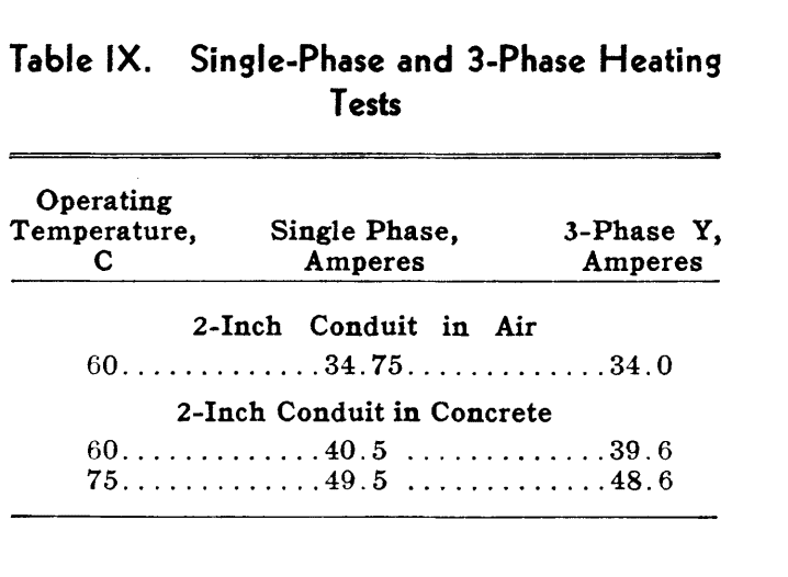

Three phase runs slightly hotter, I finally got my hands on an old AIEE study(IEEE before it was IEEE) that was discussed in the old NEC code panel discussions. I haven't read the study completely though I think my original question may have more to do with what you all were trying to get in my head about effectively having 2 wires, even though the current code does not prohibit more than that. It is possible to have more than that since the allowance gives leeway for multi-family dwellings. Thank you all for your input.
Does anyone have any theories why three-phase is hotter?
1956
(The Heating and Mechanical Effects of Installing Insulated Conductors in Steel Raceways, M. M. BRANDON, L. M. KLINE, K. S. GEIGES, F. V. PARADISE. ) https://ieeexplore.ieee.org/document/4499473/
"SINGLE- VERSUS 3-PHASE HEATING
To determine the effect on conductor heating by single- and 3-phase currents, 12 type RH-RW, no. 6 AWG wires were installed in 2-inch rigid conduit in air, and tested by first using single-phase current and then 3-phase current of a Y connected supply. See Table IX. "

It's not. This has been explained in several replies. This is a thermal problem that has nearly nothing to due with electrical circuits, except that there is a source of current. The temperature, or ampacity limits, only depend on the construction (insulation, conduit, etc.) the number of current carrying conductors and the current in those conductors. What you are seeing is ampacity limits in a few different configurations. 3 phase ampacity assumes 3 current carrying conductors in the bundle. Single phase ampacity assumes 2 current carrying conductors. That is why you are allowed to have higher current in single phase vs. 3 phase.
I believe you may have missed this part in my post
This above text is from the study explaining the table I posted, the only difference is three-phase circuits and single-phase circuits, both having the same 12 conductors in the same conduit. It took higher current for the single phase test to reach the same temperature.
That IEEE paper is behind a paywall, so I can't read it. If the 12 conductors are just laid in the duct without any special arrangement (like on the perimeter of a circle) then there are many combinations of how they can be wired as closed circuits. With single phase there are 66 combinations of 12 things taken 2 at a time. With 3 phase, there are 220 combinations of 12 things taken 3 at a time.
Each combination would have different mutual inductances to other pairs, and capacitance to ground. So it makes it exceedingly difficult to guess what is behind those numbers without reading the paper.
It would also be possible to make it a 12 phase system with 12 conductors. That too would be slightly different.
But back to basics, the OP question was about power losses. Losses in a conductor are ##I^2R## single phase or 3 phase or even DC. If there is some arrangement that gives different currents, that is a different question.

Given the (small) magnitude of the difference between the single / 3 phase currents required to produce a constant temperature (and assuming proper experiment construction), I would initially attribute the difference to some combination of:
Dielectric heating of the conductor insulation (this is the 'big' difference for 3-phase)
Inductive heating of the conduit (and other conductors)
-Some conductor 'voltage drop' values from the experiment would be a useful way to verify that the effect is 'real.'

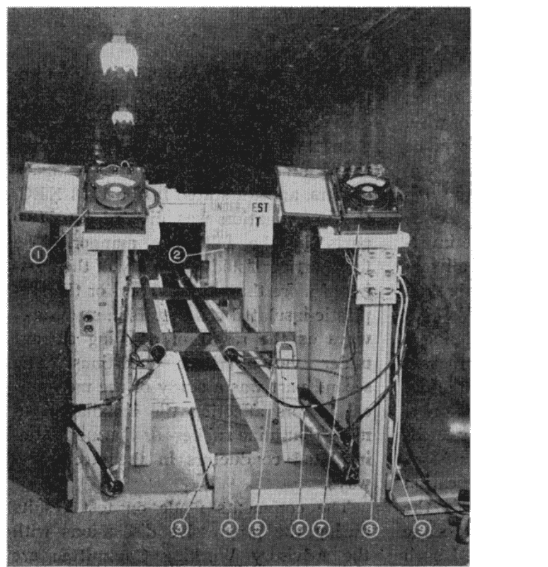

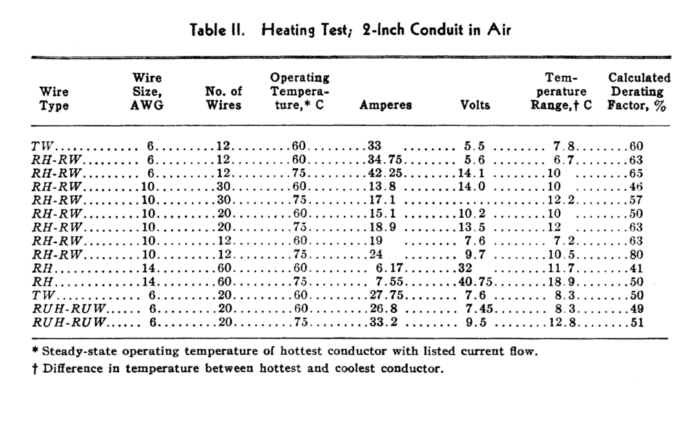

"HEATING TEST SETUPS
Conduit in Air, EMT in Air
In the heating tests on wires installed in rigid-steel conduit or EMT the wires were laid out in series and folded back on themselves a sufficient number of times to provide the number of wires to be tested. Thermocouples were inserted, as previously described, and the wires were pulled into the conduit. The assembly was placed in the test enclosure. The feeder conductors were connected to the current transformers through the fuse board (see Fig. 2), and the thermocouples were connected to the instrument in order to record the temperatures reached on the conductors (see Fig. 1). The heating source was adjusted to enable the thermostats to maintain the enclosure temperature at 30 C 41 0.5 C. The current was adjusted to give the steady-state operating temperatures desired of 60 C or 75 C.
The voltage drop in the conductors under test was recorded at the steady state operating temperatures.
For determining the steady-state operating temperature, the temperature on the hottest conductor was adjusted to the maximum value desired. This test setup also was used for load diversity, transient heating, and single versus 3-phase heating tests."
