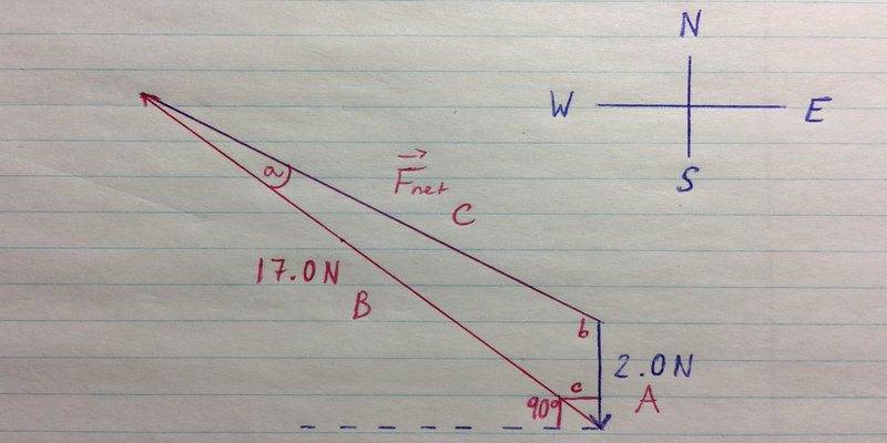

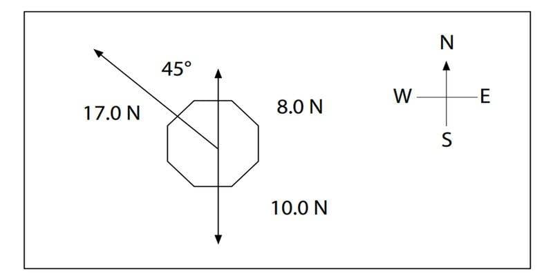

Calculate the net force acting on the object indicated in the following diagram. Show your work.
cosine/sine law
First I subtracted 10N and 8N (since they are forces acting in different directions):
-8.0N (S) + 10.0N (S) = 2.0 (S)
Then I used the tip-to-tail method:
First using cosine law to find magnitude of the net force:
c2 = a2 + b2 - 2abcosC
c2 = 4 + 289 - 2 x 2 x 17 (cos45)
c2 = 293 - 48
c = 15.6N
Now angle using sine law:
sina/2.0N = sinb/17N = sin45/15.6N
b = sin-1 (sin45/15.6 x 17)
b = 50.4
Therefore, the net force is 15.6N (S 50.4 W) West of South

Your resultant magnitude looks right, but your angle (as reported: "S 50.4 W") does not. The angles are close, so if you want to go with "S <angle> W" notation, then then your B vector would have an angle of "S 135 W". Think about it.

I think I understand what I did wrong regarding the angle. As far as I can tell based on the original diagram, 17N is (N 45 W), therefore, the angle of the net force should be (N 50.4 W). Does this look right?
Looks much better, except I got a slightly different value because I held on to an extra digit in the magnitude result (15.65), when doing the sin rule calculation.

I haven't had time to check your working but your diagram looked wrong to me. You appear to be doing tail to tail rather than head to tail if you see what I mean.

After re-doing the calculations, I got the same result (15.65).
So it would actually end up being: 15.65N (N 50.2 W).
Is this what you got?
Yes. 15.65 is over-precise, given the digit-significance of the values in the problem statement. It is good to be overprecise during intermediate calculations.
I'm pretty sure I used head-to-tail in my diagram, I don't think I got that part wrong.

Ignore this. Your diagram is correct, I miss-read it.
