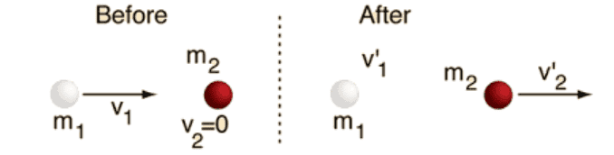

Determine the energy which body of mass m1=50 kg transfers to body of mass m2=70kg, if body 1 is moving towards body 2 with constant velocity of v1 = 20 m/s while body 2 is at rest. The collision is perfectly elastic and frontal (assuming this means the collision is central).

I assumed I was supposed to find the amount of kinetic energy body 2 receives after contact, assuming the collision is central, body 1 will be at rest after the collision.
This assumption is not justified. What made you think that ? Did you check it ?
My compliments for your clear post and the effort to ##TeX## it ! :smile:
I get the same result you find (and with ##v_1' = \frac{1000 - 70v_2'}{50} = 20 - 1.4v2' \quad \Rightarrow\quad v_1'= - 3.33 ## m/s !)
So the book answer must be in error. It happens...##\ ##

I was not entirely sure, but I assumed saying the collision is 'frontal' was an implication the collision is central, though I have not tried solving this as an offset collision. I assumed the latter:
It's the best you can do. Frontal is more a traffic term than a physics term
Bottom line: ##E_{\text kin}## of ##m_2## changes from 0 to 9.72 kJ
(hence the ##\Delta E##)
Physics: only 97% of the kinetic energy is transferred. This percentage decreases when the mass difference increases (in the extreme: 0% for ##m_2\uparrow \infty##)
Given data are 1 or 2 significant figures, so 9726.1115 is overdoing it
(and I suspect even the 6 will change if you don't round off intermediate results....)
You get the given answer if you replace 20m/s with 1m/s.
