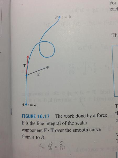

Okay, the position function r(t) implies that the particle moves on its own accord, like a rocket ship in space. Correct?
If this is not the case, then the motion is initiated by and thus comes from the force field which subsequently moves the particle and therefore work has been put into moving it. But if the path were to encounter a 180 degree turnaround the force field would then oppose the motion after the turn around and work in this case would be negative until it stops completely due to the force which would then move it back toward the turn around producing positive work. And eventually reaching a stable equilibrium at the turn around. So the particle cannot get to point B unless it acts independently of the force field.
mfb said:
It cannot, and it does not have to. Imagine the object being on rails with some other device/force (like a motor) delivering the necessary force to move it along. What is the energy this device needs for the path due to the force you consider?
The velocity of the particle is not relevant here.
It can move, but we can also just consider "what happens if it moves (for whatever reason)?".
No. Forget that concept. The particle moves, we don't know why and we do not have to care.
