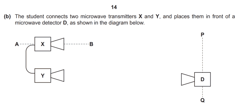

I am confued with what is meant when it says "about the line AB", does this mean horizontally or vertically? The question states that the sources produce vertically polarised microwaves (I know this is relavant) and I also know that waves moving in different planes cannot interfere. Does it mean that X is rotated "towards us" and then the full rotation has X facing backwards, "to the left"? If so, how can there be a pattern at 180 degrees as X isnt facing the detector?
Sorry if it sounds like im being stupid, I am really confused.
Thank you.
I think it means that line AB and transmitter X stay fixed in the plane of the screen while detector Y is raised and rotated above the plane of the screen keeping the distance X-Y constant. At 90°, Y is directly above X and the line joining Y and X is perpendicular to the screen. At 180°, Y is back in the plane of the screen but on the other side of X (above the words "student connects" in the figure.)
I'd take "rotated about the line AB" to mean that AB is the axis of rotation. You (the OP) are describing rotation about a line perpendicular to the plane of the page.

Suppose that at first the polarisation of waves from X is in the plane of the page.
Imagine an ant looking at X from B. In the diagram as shown, we are looking down on the top of the ant. The ant sees the polarisation as horizontal.
If we rotate the transmitter about line AB then the ant sees the polarisation as rotating. After 180° it is horizontal again. The face marked X is now at the bottom, facing away from us.
The transmitter points at B at all times.

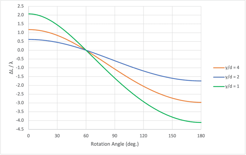

Yes, I thought of this as a path-length difference experiment not as a polarization experiment. If it's a polarization experiment, one would have to assume that there is at least some signal in the starting configuration, i.e. there is no destructive interference to begin with. Then just rotating transmitter X about its axis leaving Y and D alone, would modulate the signal as explained by @Steve4Physics in post #11.
I think that rotating X and Y as one about AB (to avoid polarization effects) as described earlier and treating this as a path-length difference situation makes the answer to the question posed, "Describe and explain the observed patterns of maximum and minimum intensity", more interesting.
Below are plots of the path-length difference divided by the wavelength, ##\Delta L/\lambda## as a function of angle at fixed wavelength. Variable ##y## is the perpendicular distance of transmitter X to line PQ and ##d## is the constant separation between transmitters X and Y.
Interference is constructive at angles where ##N=\Delta L/\lambda## is an integer and destructive where it is a half-integer. The zeroth order maximum is at θ = 60° where it can be shown with a diagram and simple geometry that triangle XDY is isosceles.
