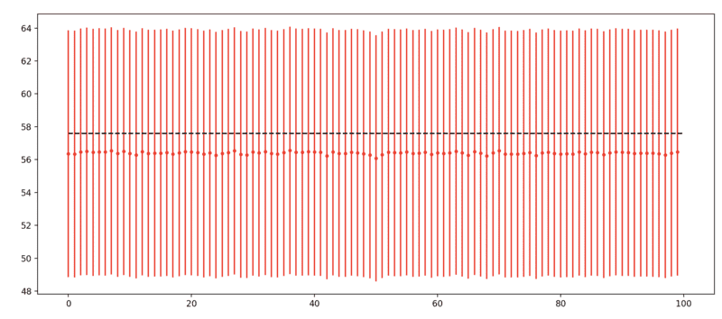

Hello! I am trying to simulate the following experiment. It is a counting experiment where the probability of getting an event after a given trial is given by:
$$P = 2\left(\frac{a}{x}+\frac{b}{c}\right)^2\left(1-\cos\left(\frac{\pi x}{x_0}\right)\right)$$
where, ##a = 4\pi##, ##b = 2000\pi##, ##c = 20000\pi## and ##x_0 = 200\pi## are fixed parameters (we can assume there is no uncertainty on them), and ##x## is an experimental parameter whose value from one measurement instance to the next changes based on a gaussian with mean ##200\pi## and standard deviation ##20\pi##. In my case this probability is about ##0.058##. In my simulations I sample ##x## 1000 times and compute P for each of these, then I sum up all the P values, which is basically the number of events I would see in the experiment (0.058 probability x 1000 experiments ~ 58 measured event), call it N. The uncertainty on N, in my simulations, I assume to be ##\sqrt{N}##. I do this 100 times and in the end I get the plot attached below, showing the number of counts for each of the 100 simulations. The black line is the expected number of counts for ##x = x_0##. I am confused about the fact that I am constantly under-estimating the true value and by the fact that I am so much closer to the true value than expected from the errors. Can someone help me understand what am I doing wrong? Thank you!

I definitely don't know much about statistics, but usually when I was assigning an uncertainty on a given number of counts (for example on a bin in a histogram and assuming more than ~10 counts or so), I was using ##\sqrt{N}## as the statistical uncertainty. So in this case, after 1000 measurements I would have ~58 counts, so I assumed the uncertainty would be directly on the counts that I physically measured i.e. ##\sqrt{58}## and the value of the probability for example would be ~##0.058 \pm \sqrt{58}/1000##. Why would I divide by 1000 under the integral and then once again when moving from counts to actual probability?
Test it out: instead of 1000 do 4000 or 9000 and see what happens to the scatter

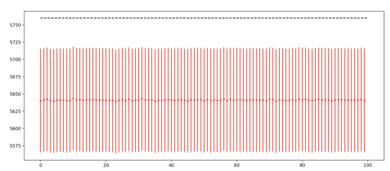

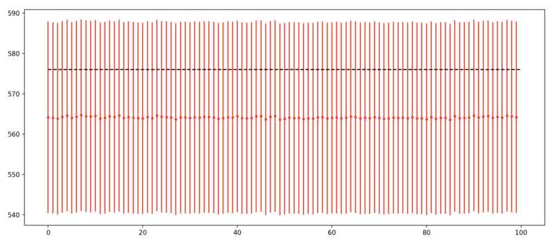

I am attaching below the result for 10000 and 100000 events per experiment. It seems like the more events I have the more I underestimate the uncertainty... Now I am really confused

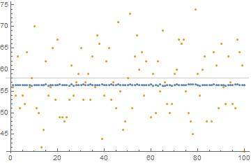

This is the issue.
You need to not sum up the P values. You need to sample a Bernoulli RV with each P value. In the figure below the blue dots are using the "sum up all the P values" approach, while the orange dots sample a Bernoulli RV with each P value.

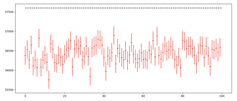

Thanks a lot! I see, I initially wanted to do that, but it seemed more complicated to implement and I went for the sum. But why are they not equivalent (in the limit of large number of events)?
EDIT: That still seems to underestimate the true value for high number of event. I am attaching below what I am getting for ##10^6## event per point. I am still not sure why this is happening. Shouldn't my uncertainty account for that, even if I might underestimate the true value?

That is achieved when ##x = x_0##. Basically it would be the value I would measure all the time if I had no uncertainty on ##x##.
If you look at ##P## you will see that its range is substantially asymmetric about ##0.058##. It is close to the maximum, so there are very few values of ##x## that produce ##P>0.058## and there are many values of ##x## that produce ##P<0.058##. So the overall result will be naturally biased low.

Sorry, I missed this. Where did you apply the propagation of uncertainty?
In general, the standard uncertainty propagation formula uses a first order Taylor series approximation. So it will only be exact for a linear function. This problem P is quite nonlinear. Probably you would need at least a second order expansion.
