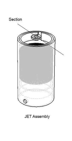

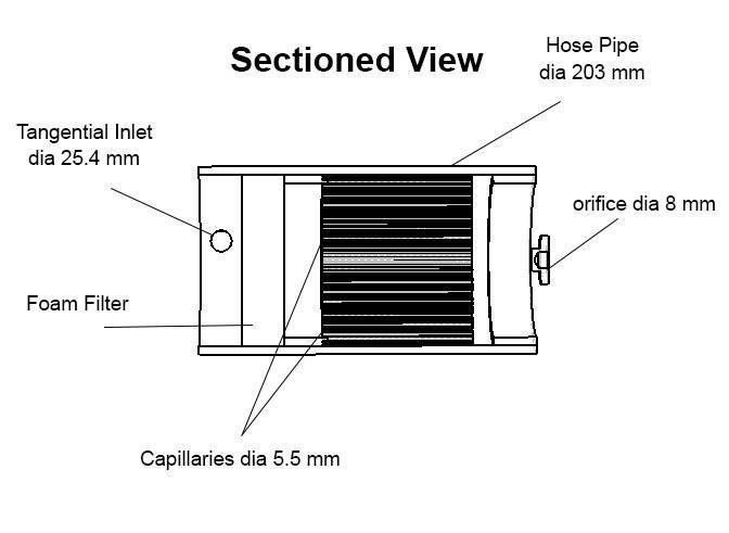

Let me tell you the whole working of my jet which I am going to use to produce the laminar stream...
Water is pumped into the jet through the tangential inlet attached at the bottom of the Jet, this tangential inlet creates a rotational flow and passes through a filter (foam) to decrease the initial turbulence and make the velocity profile bit uniform then the flow is divided to pass through the capillaries having a very small diameter which creates a shear stress and decreases the velocity of the flow and this is the portion where "Laminar Flow" is created.
After passing through the capillaries flow is passed through the outlet, velocity has to be low at this point as well to avoid the turbulent transition but the velocity is getting high around 5.6 m/sec which is producing a Re of 120,000 using reynold's number for pipe flow
It would be really helpful if you could provide a schematic diagram of the system.

@Chestermiller here are the schematics Sir and it would be really helpful if you can watch some videos related to laminar fountains on youtube

OK I got the concept that shear forces will act in an open stream as well Thanks for that. I am using water in my jet the thing which I said above was for the interaction between water and air, which is now clear.
In order to get the height of 6 feet I got my velocity of 6.06 m/sec using Bernoulli's equation (V= sq. root 2gh as the Gage pressure is zero and at max height velocity is zero), now for the Reynolds number at the orifice, diameter is 8 mm, density of water 1000 kg/m^3, dynamic viscosity of water is 0.000404 kg/(m.s) which will lead to Re of 120,000
Yes that's what I'mm stuck in it,I know that Reynolds number can get into millions for different situations but I'm not getting any reference for this type of flow which is occurring in the laminar stream right after the nozzle. can you please provide me a reference so that I can mention it in my research papers?
Well with those numbers (which indicate that your water is at 70°C?), then your Reynolds number seems to actually be that high. Laminar-turbulent transition in jets is a well-studied phenomenon, so if I were you I would search through journals to see what you turn up.
