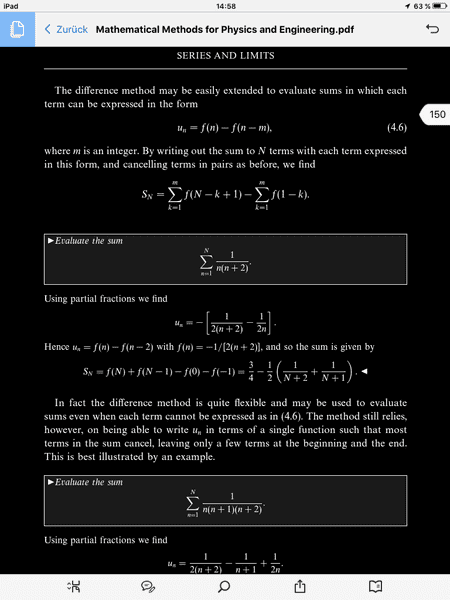

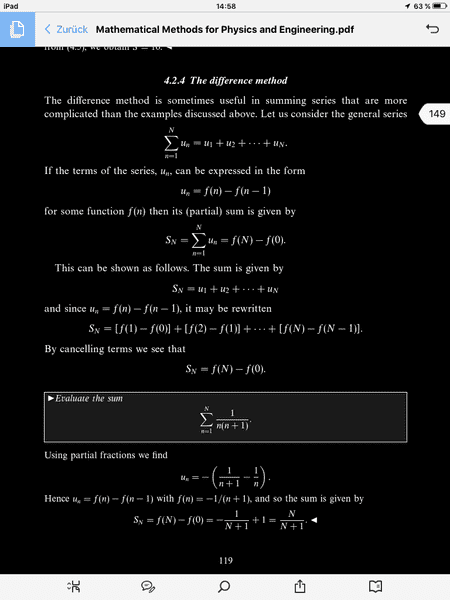

Yes it is K.F Riley and M.P Hobson' book.. Third edition.. Here they are..
I just curious about the formula... Is it really work? If it is, is there any exception?

I understand what you mean sir... But there is something bothering me from the book... For example : Evaluate the sum $$\sum_{n=1}^N \frac 1 {n(n+2)}$$
Using partial fraction we find $$u_n=-\left[\frac 1{2(n+2)}-\frac 1{2n}\right]$$
Hence ##u_n=f(n)-f(n-2)## with ##f(n)=-\frac 1 {2(n+2)}##, and so the sum is given by $$\begin{align}S_N&=\sum_{k=1}^m f(N-k+1)-\sum_{k=1}^m f(1-k)\nonumber\\&=\sum_{k=1}^2 f(N-k+1)-\sum_{k=1}^2 f(1-k)\nonumber\\&=f(N)+f(N-1)-f(0)-f(-1)\nonumber\\&=\frac 3 4 -\frac 1 2 \left( \frac 1 {N+2} + \frac 1 {N+1} \right)\nonumber\end{align}$$
There exist ##f(-1)## even if the original summation begin from ##n=1##!
So, back to our problem, if i apply the formula from the book directly i'll get ##S_N=f(N)-f(0)## not ##S_N=f(N)-f(2)## as we know it'll produce the right answer. Precisely, my question is why we can't apply the formula directly to produce the right answer? Is there any error in the formula or something i don't urderstand yet? The example above i took from the book. You may look at the picture I've uploaded before.
