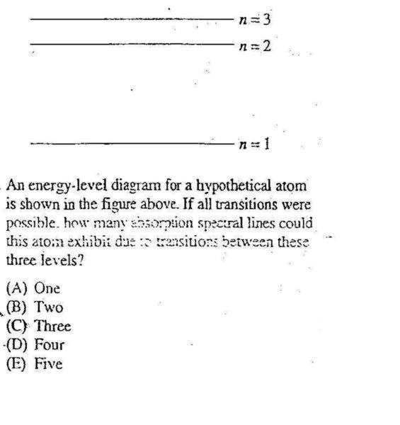

If an atom in energy level 1, how many absorption spectral lines can an atom exhibit due to transition between 3 levels? How about 4 and 5 levels? And also in emission?
Concept
I am confused one book says it can absorb a photon to the third level at once, or to n=2, so there is only 2 possible transitions. Another book says it can absorb once to n=3, n=2, and from n=2 to n=3, so there are 3 possible transitions in total. How am I supposed to count the possible transitions? Here’s a question I encountered, but I need to know how to solve any problems of this kind. Any help is appreciated, Thanks in advance!

I forgot to post the problem,too.

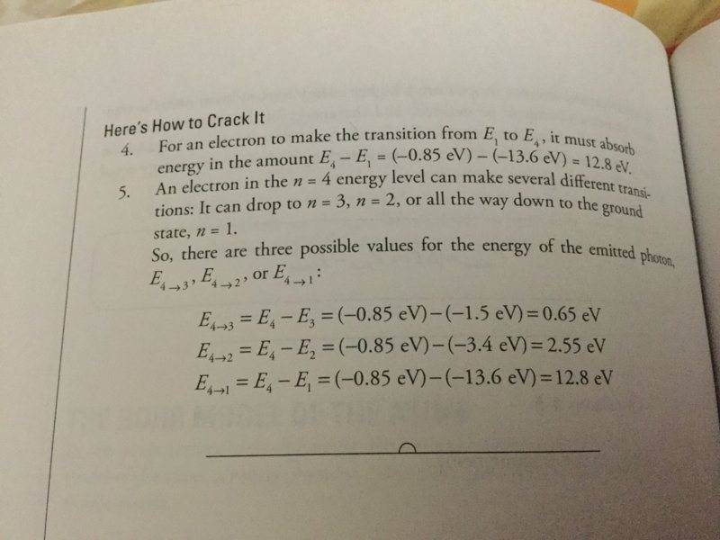

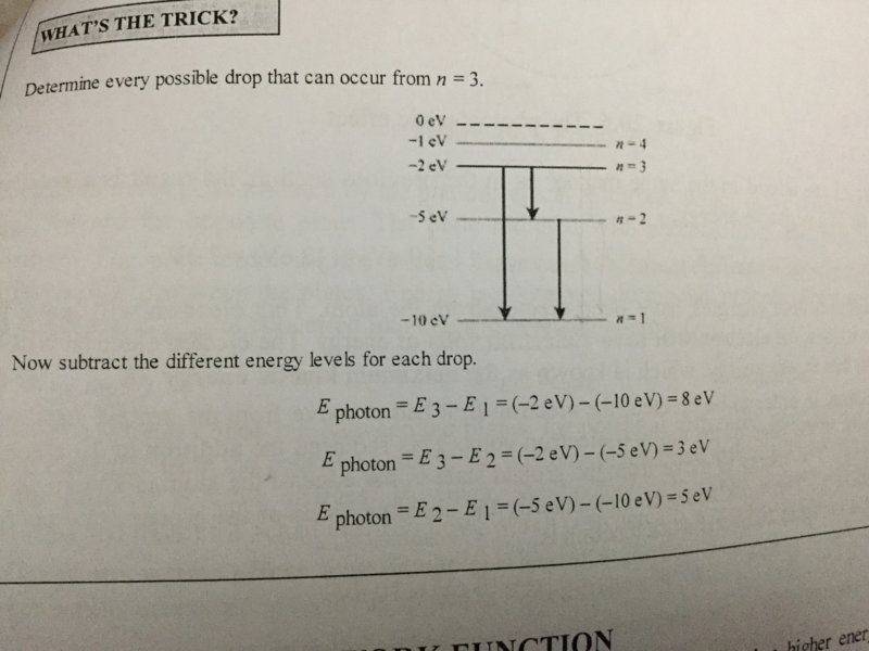

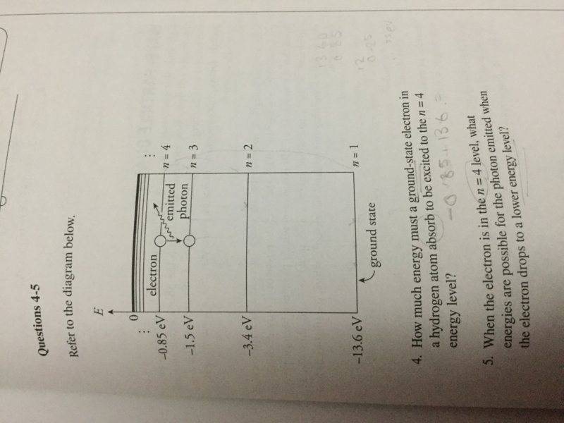

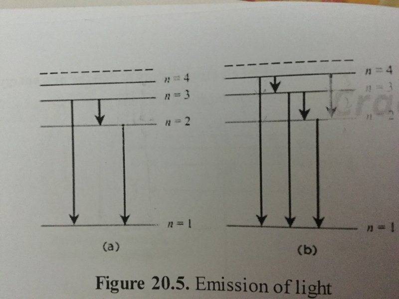

Here they are.
The number of spectral lines are asked "if all transitions were possible ".
So they are indeed three possible transitions.
Yes.

YMMMA said:
Here they are.
I see no inconsistency. Some of these texts are considering only transitions from a given level, not all transitions between the levels in the set.
So why in question 5 didn’t we include transitions from n=3 to n=2 and n=2 to n=1, and n=3 to n=1...
Because that question specifies transitions from level 4.
This is not the same as asking for all emission lines, since that would include 3->2, 3->1 and 2->1.
Got the difference, thanks!
