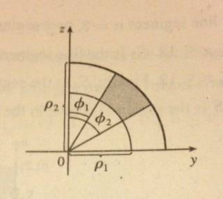

Why is the spherical wedge (shaded) graphed on the z-y axis? In the most general case, shouldn't the two lines that form angle $\phi_1$ and $\phi_2$ be arbitrarily placed (such that $\phi < \pi /2$) and not necessarily lying on the z-y plane? Since it is to my understanding that $\phi$ is measured from the positive z-axis in any direction away from it, or did they draw it on the z-y plane for illustrative purposes?

Hey Rido! (Smile)
You're quite right. Those lines represent cones that have a fixed angle with the z axis.
Indeed, it's for illustrative purposes that only the intersection with the z-y-plane has been drawn. (Wasntme)
