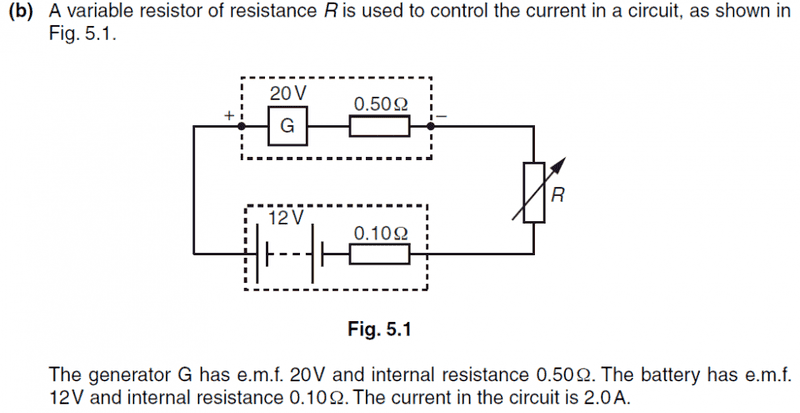

Confused with circuit that has two opposing emf
In summary: The Attempt at a SolutionI used the P=VI formula to calculate the total power generated by G which is 40W, and the answer turns out to be correct. But actually, I don't quite understand this topic of opposing emf. Like, why I can't I use the formula of P= V2/R instead? Why can't I get the same answer?Different components in the loop have different behaviour as to power consumption.
toforfiltum
341
Calculate the total power generated by G
P=VI
I used the P=VI formula to calculate the total power generated by G which is 40W, and the answer turns out to be correct. But actually, I don't quite understand this topic of opposing emf. Like, why I can't I use the formula of P= V2/R instead? Why can't I get the same answer? For when using this equation, I know that I musn't include the value of 0.5Ω, which is the internal resistance of G. But why can't I get the same answer?
Same goes for P=I2R. These three formulas all give 3 different answers, though I thought they are supposed to give the same value of P. What is wrong with my understanding?
PG = 40W which must be consumed by "somebody": Here they are:
- The battery consumes V*I = ( EB + RB*I ) * I = EB * I + RB * I2 ( you may call EB*I the charging power ).
- The internal resistor in G consumes RG * I2.
- Rightmost resistor, R, consumes R * I2.
Now, try to calculate the value of R and balance the account.

ehild said:
The power generated by a battery is its emf multiplied by the current flowing through it.
P=IV= V2/R = I2R is the power consumed by a resistor R, if I current flows through it and V=RI is the voltage across it.
Ah, so I see that the P=VI, P=V2/R and P=I2R only applies to power dissipated by the loads in the circuit. Now I see where I'm wrong. Is it so because the V in the equations refer to the potential difference across circuit?

Yes, over the terminals of "G&0.5Ω" a voltmeter will show 19 V.
But over the terminals of the battery plus the 0.1Ω a voltmeter will show 12.2 V in the given circuit.
And you already calculated the value of R to make it work as described ?
The term 'net emf' is a bit vague. Who said the net emf in this circuit is emf of G (20 V I suppose you mean) minus that of the battery (12 V ?) ? What is true is that the three resistors in series have to deal with a total potential difference of 8 V. And yes, there is an emf of 12 V in the circuit; a potential difference in the opposite direction of the current.
Yes, the value of R is 3.4Ω.
The presence of this emf acts as a resistor and also to reduce the circuit's pd or emf (not sure) is it? Are these two things the only significance of the presence of this opposing emf?
Wait, if 8V is the total potential difference in the circuit, why must we use the 20V value when calculating terminal potential difference across G? Why not 8V?
Imagine a resistor which is a simple straight wire of length L. The charge is driven across a resistor by the electric field E inside the resistor wire. While the charge moves from one end to the other, work is done by that field, and the work is equal to W=EqL. The work done on unit charge is equal to the potential difference across the wire. In practice, we call the negative of the potential difference "voltage" V. So the work by the electric field inside the resistor on charge q is W=qV. That work is lost, it transforms into heat, the resistor "dissipates" it. The power is the work done in unit time, and the charge flowing through the resistor in unit time is the current, I. So the power dissipated by the resistor is P=VI. According to Ohm's Law, V=RI. So the formula for the power dissipated by a resistor R can be used in three forms: P=VI=V2/R=I2R.
In a battery, there is a chemical reaction that separates the charges of opposite sign and cumulates them on the terminals. The chemical work is opposite to the electric work of the field between the opposite charges.
As the terminals of the battery have different charges, there is a potential difference across them. The potential difference across an unloaded battery is called emf - the electromotive force of the battery, denoted by ε .
When the battery is loaded, we get back the chemical energy as electric work done on the charge flowing through all the resistors in the circuit, including the internal resistance of the battery.
When current flows, the charge on the terminals would decrease, but the chemical reaction produces new charges continuously. The emf of the battery is kept constant, and the chemical work is W = ε * q, the power is P=ε*I, the power generated by the generator.
When you use the term emf it means electrical potential difference due to some non-electrical process. The voltage across a resistor is not "back emf ".
Likes toforfiltum
The total potential difference in a loop is zero. The 8 V is the net potential difference across all resistors. The problem asks the power generated - supplied - by the 20 V generator.

Recall Kirchhoff's Voltage Law (KVL) . http://www.electrical4u.com/kirchhoff-current-law-and-kirchhoff-voltage-law/
Thanks. I have another question. If there are two opposing emf sources in a circuit, and one source is greater than the other, will there be current from the smaller emf source?I don't think so. Am I right?
And if so, will the emf of the smaller source become like a resistor and cause a voltage drop that is equal to its emf value?
You 've got it right.

Seems counter-intuitive, but when you do AC theory you will see a more practical example. In 3-phase AC system, there are 3 voltages of equal magnitude, but they are 120° out of phase with each other (rather than 180° in your example with 2 sources). When you add them up, the total is zero. This is the neutral point. The currents flow from one line through the neutral into the other lines. As long as the voltages are equal and opposing it is quite safe to touch the neutral point. And in fact, this point is connected to Earth for safety.
  • #35
William White said:
If you touched a circuit where the sum of voltages was zero you would not feel a shock (as long as you were standing at zero voltage - say on the earth)
Seems counter-intuitive, but when you do AC theory you will see a more practical example. In 3-phase AC system, there are 3 voltages of equal magnitude, but they are 120° out of phase with each other (rather than 180° in your example with 2 sources). When you add them up, the total is zero. This is the neutral point. As long as the voltages are equal and opposing it is quite safe to touch the neutral point. And in fact, this point is connected to Earth for safety.
Haha, this is out of my depth.I don't get the out of phase thing:smile: Guess I'm not there yet. Physics is hard to understand intuitively..
