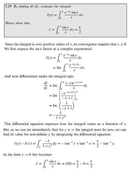

The question is as attached.
I am very confused by the question. Firstly is I(y) a function like (tan-1y) or an operator like ∫y?
Then they say I(y) - I(∞) = (∏/2) - tan-1y so I suppose that I(y) is basically just -tan-1y.I(y) - I(∞) = (∏/2) - tan-1y
lim(y→0) [ I(y) - I(∞) ] = (∏/2) - 0 = (∏/2)
But returning to the question, as you let y→0, all you get is
y(0) = ∫ sinx /x dx = tan-10 = 0
But that doesn't look right at all.I hope someone can clear up all the terminology they are using...

The terminology is very clear: I(y) is a function of y, given by a formula in the picture.
RGV
But when they take the limit of y->0, all you get is I(0) = ∫ sinx /x dx = tan-10 = 0When you take the limit of y-> ∞, all you get is I(∞) = 0 (If you substitute ∞ into the question)

They say very plainly that I(\infty) = 0, so I(y) = \frac {\pi} {2} - tan^{-1}(y), including y = 0.
Oh I think I got it now! Cause when you integrate ∂/∂y = - 1/(1+y2) you get
I(y) = -tan-1y + C
Based on the first equation, we know y(∞) but not y(0).
I(∞) = 0, so you solve C = ∏/2...
Everything makes sense now, thank you!
